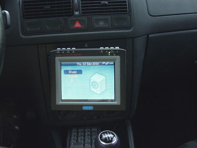

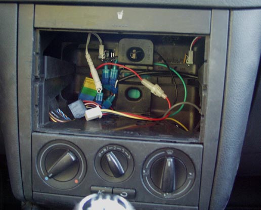

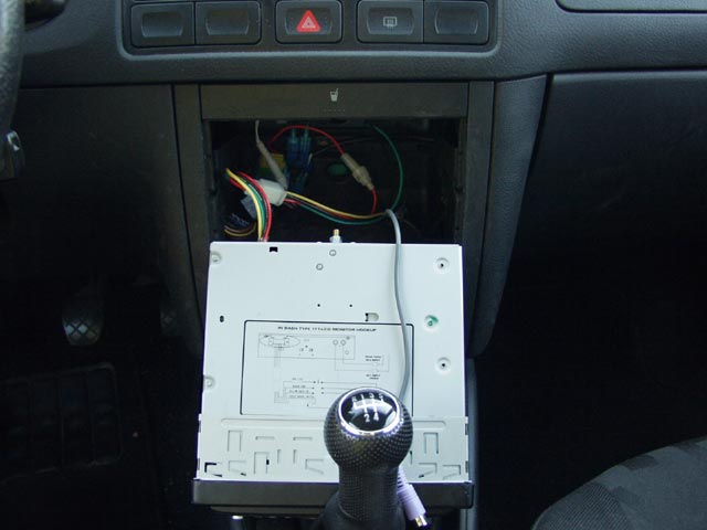

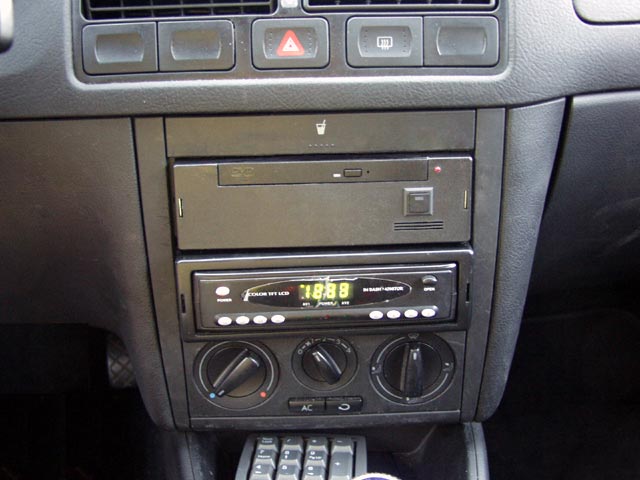

    Here we go.
    Before installation: no headunit, just wires:
    Installing the in-dash monitor
    Everything is in place.

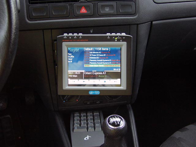

    PyCar is running from the 32MB DOM module
    So far I installed it all with the keypad. But I'll change that later either for touchscreen( when price go down... ) or attach the PC to the HU( cheaper though ! )
    Once I install the amplifier, I'll go to the showoff section. Finally !!!
