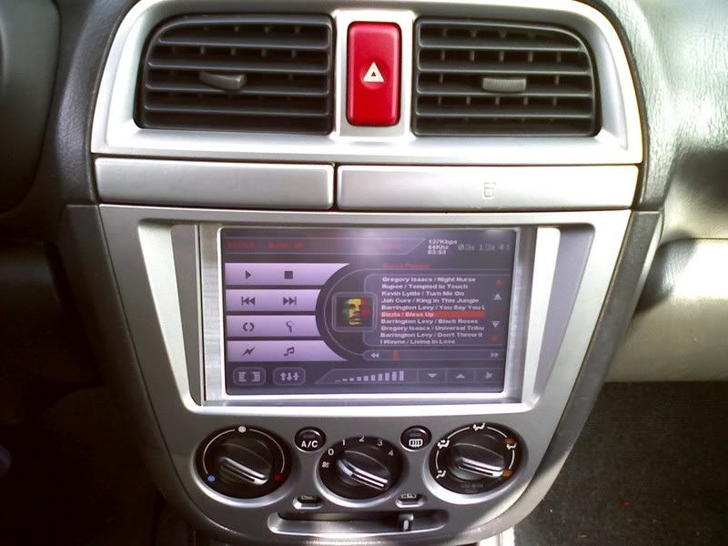

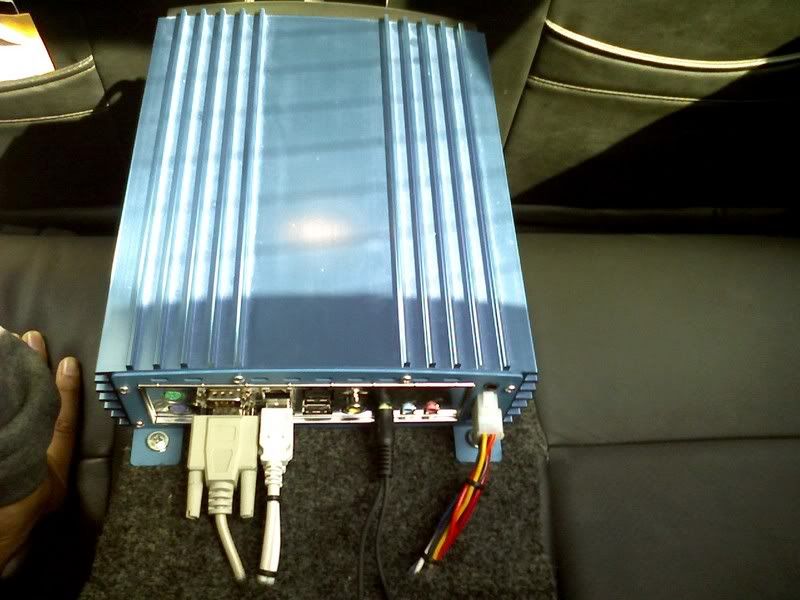

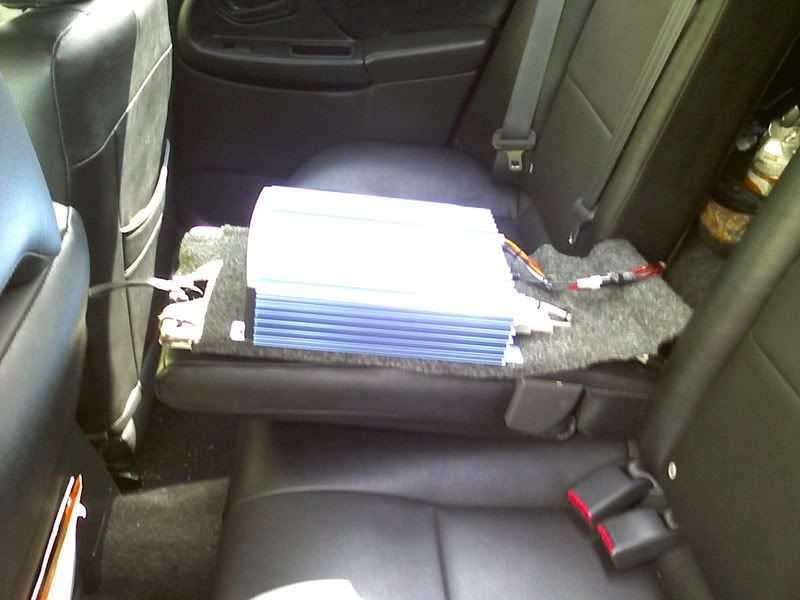

    "salvi" put it together and installed it last week.
    specs are:
    VoomPC case, VIA 1.5GHz motherboard w/ processor, M1-ATX Power supply, 1GB of RAM, 120GB HD, 2.5" Notebook HD to 3.5" IDE Converter, Lilliput Eby-701 7" Touch Screen, GPS Receiver
    Im very happy with the purchase, great price, attention to detail and did I mention great price?
    PM him for details.
    and here are some pics.
    dont mind my running shoes in my trunk

      Nice setup. Question - how are you getting sound to the speakers? With the Double-DIN in dash do you have a radio somewhere else or external amplifier?
      Thanks!
        Sound to the speakers is provided via a 4 channel amp. There is no head unit on the vehicle, everything is controlled via the CarPC.
