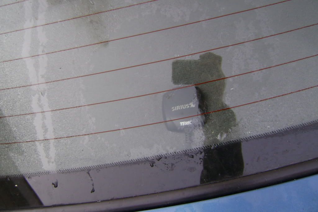

    I like to put my Sirius antenna on the rear deck because it is much easier than trying to run that little wire under the rear window gasket. It works great, no problems.

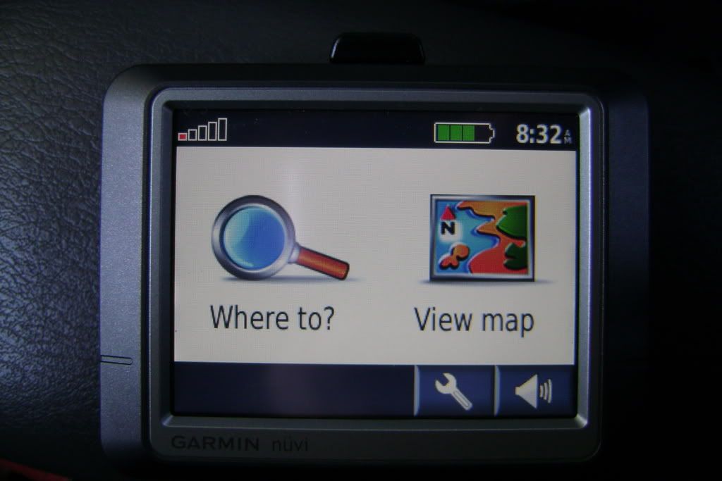

    This is my Garmin Nuvi 260. I was thinking about mounting it right above the vents. I think it would look okay but I am thinking that I may just move it out of the way and connect it to my carputer. I am going to look into getting a usb cable and downloading nRoute.

    4) Possibly hook up the Garmin for GPS if this turns out to be a viable option.
