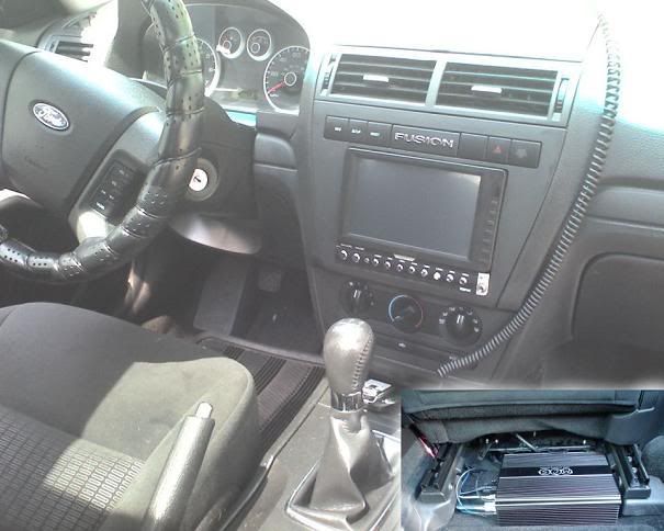

    in place of the head unit is a 7" touchscreen VGA monitor (Lilliput EBY-701) and 1/2-DIN audio equalizer (Clarion EQS746). the equalizer allows for hardware control of master volume, subwoofer volume, front/rear fading, aux input switching, and 7-band equalization
    under the passenger seat is a MoCoSo.com aluminum mini-ITX carPC case. inside the case is an Intel D201GLY2A motherboard/CPU combo, a MiniBox M2-ATX [DC>DC] carPC power supply with built-in startup/shutdown controller (it turns the carPC on/off automatically with the car's ignition key, just like a standard headunit), and a 40GB 2.5" laptop hard drive (40GB is fine for my needs, and is easily upgradeable if more storage space is needed).

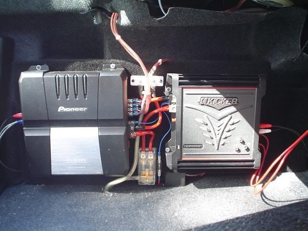

    in the trunk are two amplifiers. a 400w (200w RMS) 4-ch Pioneer GM4300F that powers 6 door speakers and 2 rear deck speakers, and a 800w (400w RMS) Kicker ZX400.1 that powers two 500w (250w RMS) 12" MTX Blue Thunder legend subwoofers.

        all power/audio/video connections in the EBY701 run through a single 16-pin connector. I already ran power wiring for the monitor to the terminal block. I didn't need to use the monitor's built-in speaker for anything so the audio is left unconnected. the other connections are a VGA cable to the carputer (for the video), a USB cable to the carputer (for the touchscreen interface), and a single RCA cable to the trunk (for the backup camera).
        once all the wiring is completed, the monitor was ready to be hooked up. to secure the monitor I attached velcro to the back and bottom of the monitor enclosure. the bottom velcro attaches to the top of the equalizer, for the back I bolted a short piece of aluminum flat stock across the stock radio opening using the top two stock radio bolts.
        • [li]Center Bezel Modification:[/li]
        the stock center bezel is opening is almost the perfect size for the EBY701 (horizontally it's about 1/4" to short, and vertically it's about 1/4" too tall). before I installed the equalizer I only had the monitor itself in there. all that was required to fit the EBY 701 into the stock radio opening was to simply file about 1/8" from each side (because of the switches on the right side, I filed mostly on the right side to make the screen sit more in the middle).
        to add the equalizer required cuting/filing about 3/4" off the top the opening (to move the monitor up). I used a roto-zip to cut the opening out larger, then used a file to smooth out the edge. at some point I may epoxy the monitor bezel to the car's center bezel, then fill, sand, and paint it to for a cleaner look, but for now I'm ok with the aesthetics (it looks similar to the stock radio as far as aesthetics are concerned).

        • [li]PC installation:[/li]
        I installed the PC under the passenger seat for several reasons; it allows access from the driver's seat (with the passenger seat pushed forward all the way), it keeps the wire/cable lengths shorter, and allows it to operate in the ambient temp of the passenger compartment (as opposed to the extreme heat/cold in the trunk). the case fits perfectly right under the seat and cannot be seen when the seat is pushed back. to push the case up a little further I cut a notch for the seat's wire harness which allowed me to push the PC back about another inch. it is not physically secured to anything, it just sits there, wedged in by the seat brackets/plate and the rear carpet. I could easily attach a couple velcro strips to it hold it, but it's not necessary.
        • [li]Audio Amplifiers and Speakers[/li]
        there is no traditional head unit in my car (the carputer IS the head unit). since a computer cannot amplify the sound up to speaker level, an outboard amplifier was required to do this. I have two amplifiers in my trunk, a Pioneer GM4300F 4-channel 400w (200w RMS) amp to power the 6 door speakers (wired in series and connected to the stock radio harness) and two Pioneer 6x9 three way speakers in the rear deck. I wired the door speakers in series to raise the impedance seen by the amplifier. this lowers the power output of the amp and reduces audible distortion (the door speakers are still stock, they would not exist if I tried pushing 50w RMS into them ) amp channels 1 & 2 power all 6 door speakers (fed by the equalizer's front outputs). amp channels 3 & 4 power the rear deck speakers (fed by the equalizer's rear outputs). I also have two 12" MTX Blue Thunder Legend subwoofers (yes I know, they're old!) powered by a Kicker ZX400.1 800w (400w RMS) mono amp (fed by the equalizer's subwoofer output).
