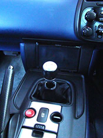

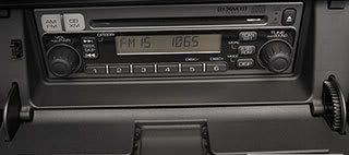

    Original Headunit
    First Idea:
    I decided to go for a Single DIN with a flipout screen.
    The large overhang of the dash over the headunit ment it would have been very close with a flipout screen
    I tried all different models none seemed to fit some came very close but no luck.
    I could have extended the radio bay forward a little but I personally didnt like the look of it
    so back to the drawing board.

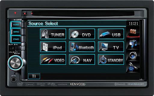

    Second Idea:
    I then thought to fit a Double DIN unit with a bit of fabrication work I thought it could fit.
    Another problem accured, the heating system that goes to the vents was so close and tightly packed in.
    If i wanted to fit this I would have had to cut a large amount of the system out
    resulting in loosing heating in the car so i quickly discarded this idea.

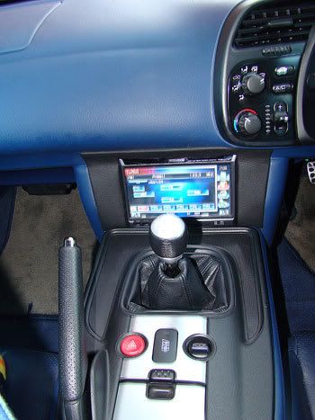

    Third Idea:

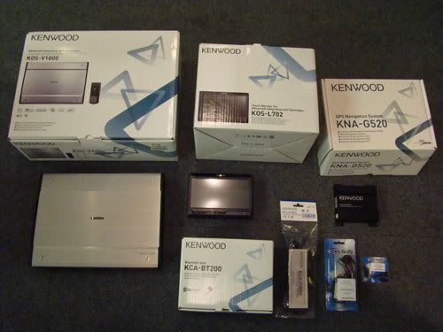

    After alot of scratching of the head, I thought about having just the screen in place and having the workings of the unit else where, without the screen and the workings all together the screen would only be a few 'mm' thick giving me enough room and then if i get a touch screen I could control everything via the screen and put the workings elsewhere in the car.
    After alot of research I found just the thing and it did exactly what I wanted from it!
    After I found the kit it was time to buy heres the kit.

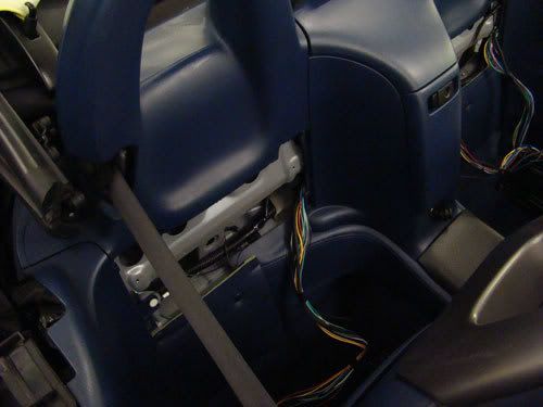

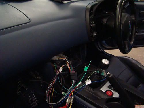

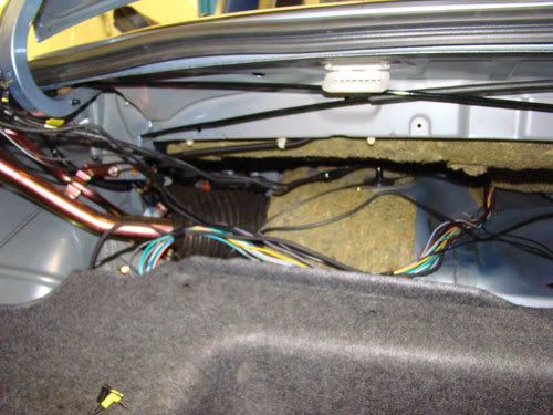

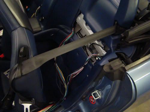

    First the old unit and radio harness was taken out and new wiring loom connected.
    Wiring was passed under the carpets, behind the seats and into the boot
    where the control unit will be placed.

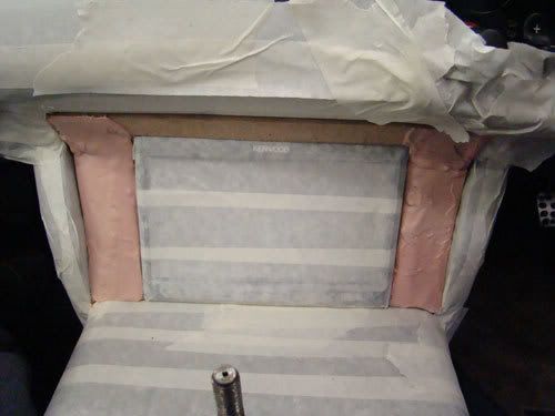

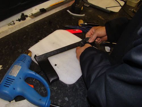

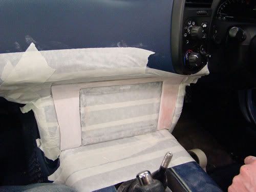

    Now the wiring was complete it was time to fabricate the screen into the dash

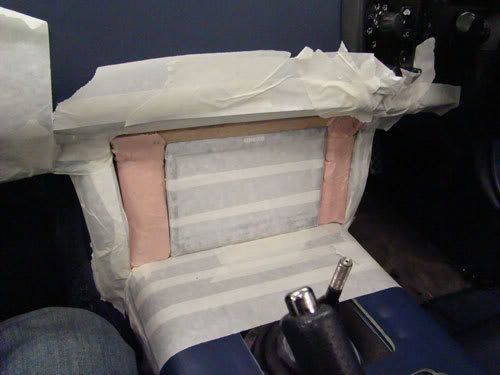

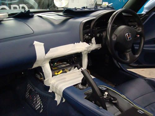

    Before this could be be started the centre console was removed and masked up

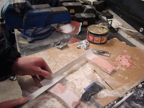

    First a square wooden structure was made to fit inside the opening making sure it fitted nicely
    After this a resin was used to get the desired curve effect of the dash
    Once the desired effect was almost achieved it was time to remove the front and to
    smooth out the lines.
    Then was placed back several times to make sure it looked correct.
    Once looking good it was removed one last time and covered in a plastic to
    match the centre console.

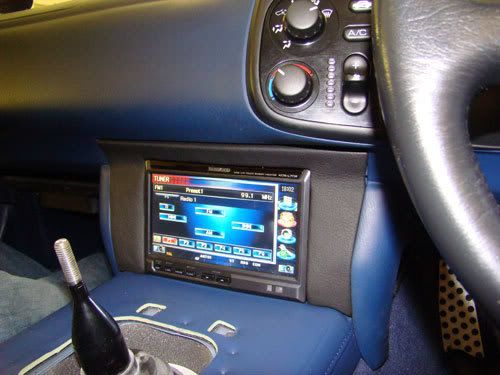

    All masking removed and the unit placed back.
    The centre console was then placed back and admired the work.

      can you list all the part you used i like this idea and think it would work out better for me as well and what was the cost about
        I like it because the s2000 stock interior is dreadful... but i feel like the shifter could be a problem, accidental touches, and hard to get to if in an odd gear..
          That screen doesn't look like it's VGA. Are you sure it's going to work?

            i have had it in for a couple of weeks all works perfect garmin sat nav, parrot bluetooth etc
              How does the video connect?

                nice fabrication, but how is this a car computer?
