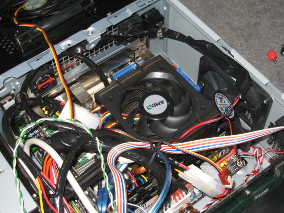

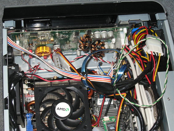

                Re did wiring today and added new amp and rear speakers. Updated the pictures above and removed the old Sounds so much better with everything in. Still waiting on headliner antenna, cameras and that should be it.

                    Got everything setup last night and it is so much quicker than the original setup. Definately worth it for quicker bootup.
