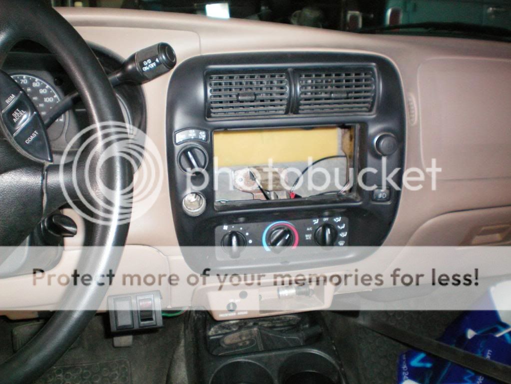

    There's a lot of room back there, but just enough that I couldn't really work in there to connect cables and such. Besides, I had a working Voompc-2 case to put everything in.

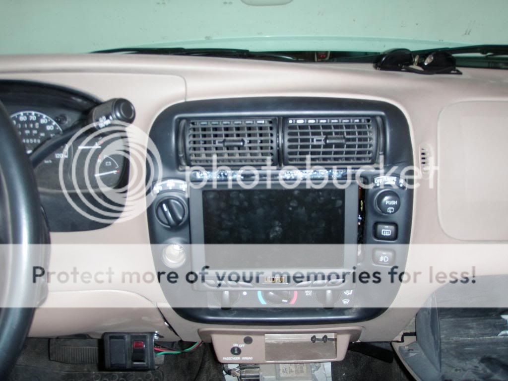

    The bezel is from a Ford Explorer that I picked up at the local junkyard. There were some extra switches, so I grabbed them too.
    I turned the rear defogger switch into an on/off switch for the computer. I also have the power LED from the computer running to the LED in the switch.
    As for the rear window wiper selector, who knows? It's got 3 positions and a push button in it. Maybe I'll buy a Fusion Brain and play around with it.
    Oh and it's being held up by some trim adhesive, which I know looks bad. I've got another case and bezel on the way. I'll learn how to fabricate then.

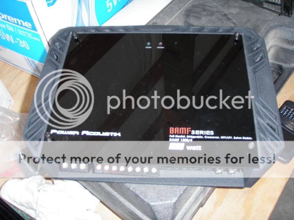

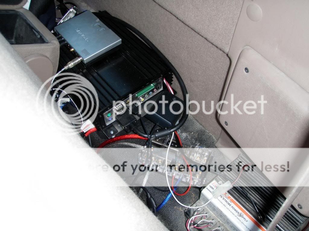

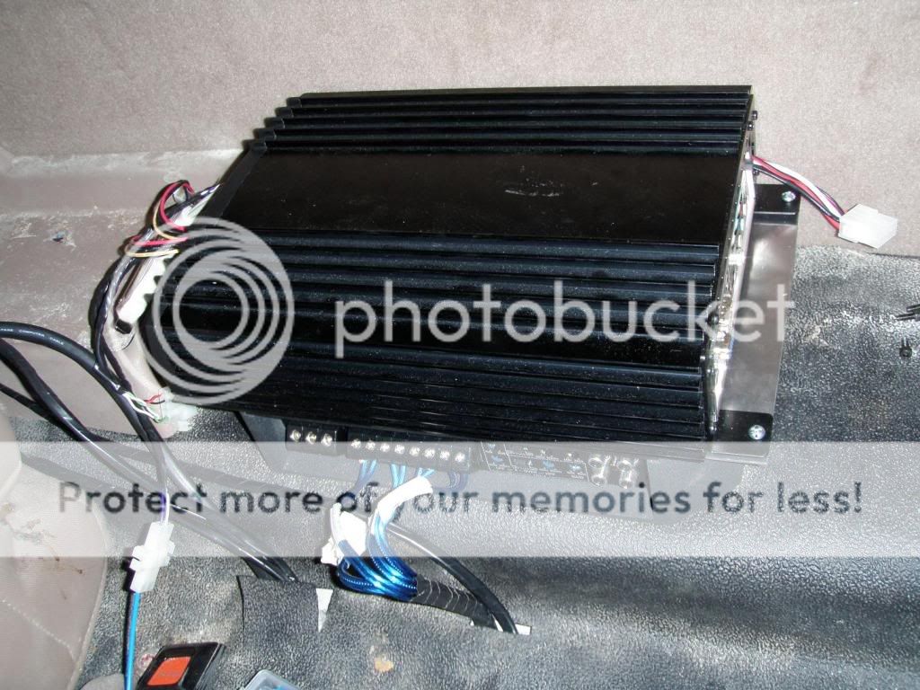

    I chose this amp because of its small size and flat top. But it doesn't have any external fuses! The manual says 25A x2 but I don't see them anywhere, inside or out. Kind of makes me worried, but we'll see.

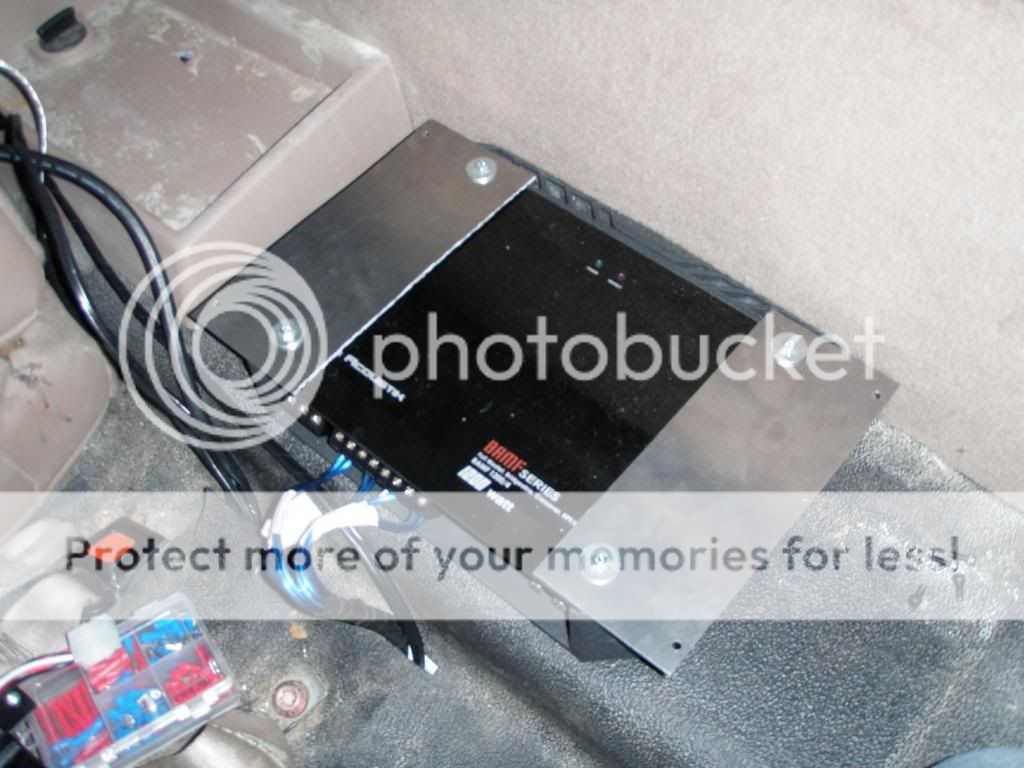

    Fits perfectly on the small space behind the seats.
    I had some spare sheet metal, so I cut up two pieces and screwed them to the amp using the existing holes holding the top down on the amp.

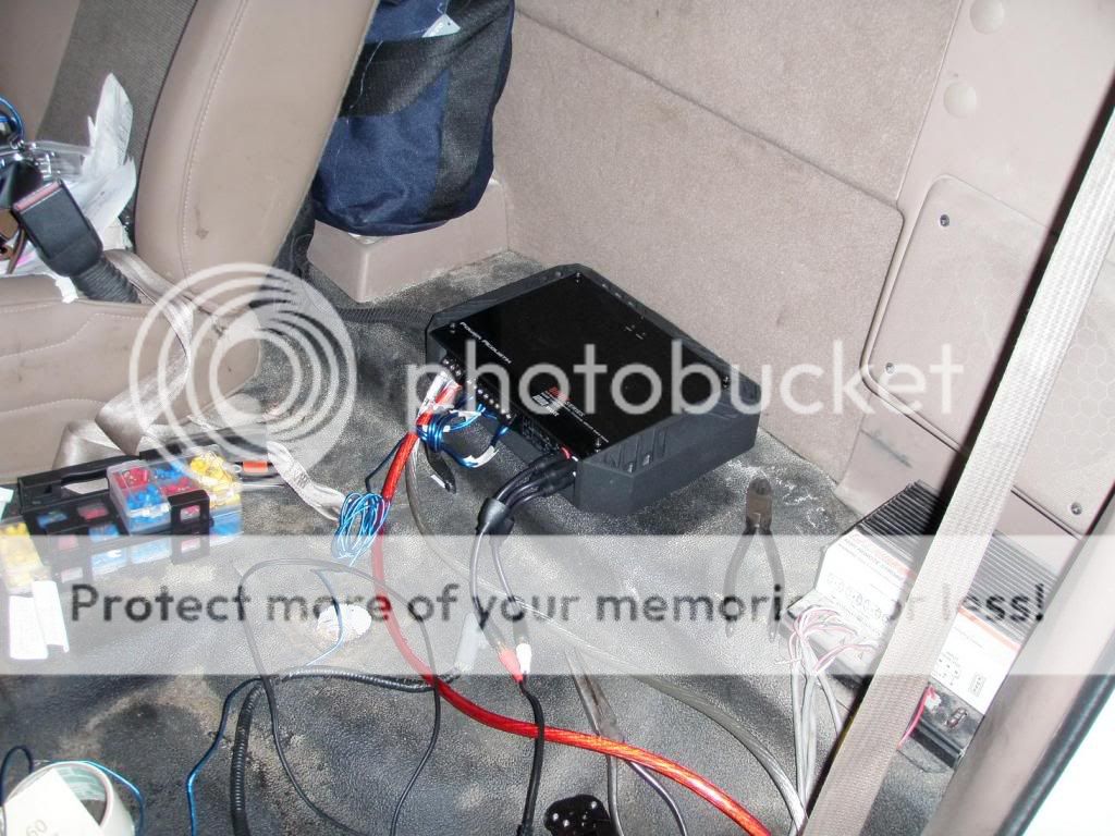

    VoomPC-2 case fitted on top of amp. I don't like this case btw. I couldn't find any of the connectors to add more wires for power to the screen and hub. I also need to run wires out for the power switch. So, I just popped open the DVD slot and ran everything out through the left. There's also a 4 port USB extension directly connected to the mother board sticking out.

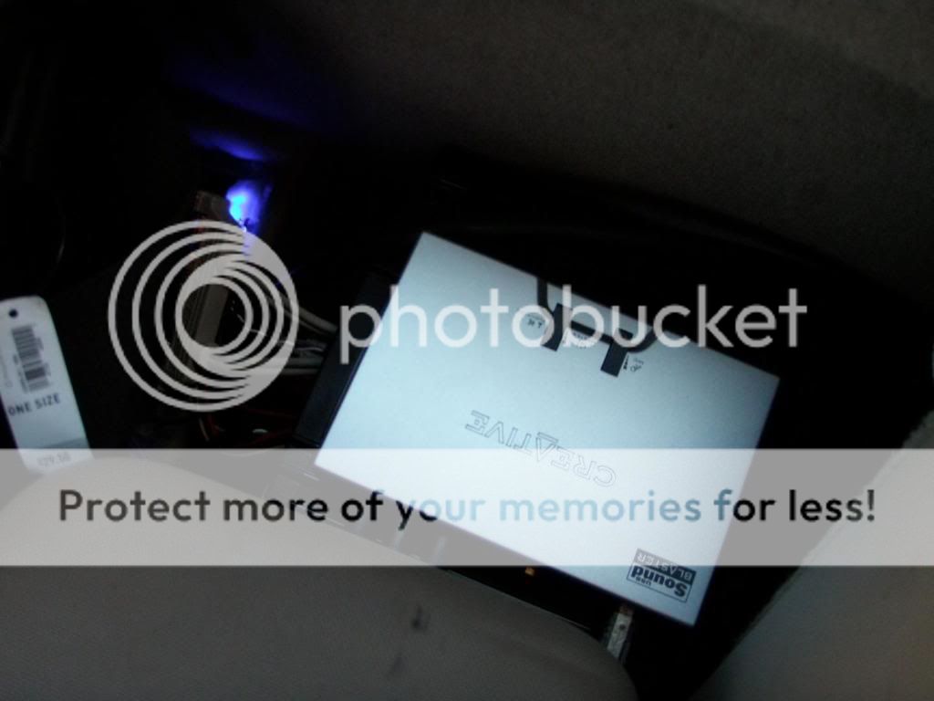

    External USB sound card. Although I'm no audio guru, this sure helped out a lot with the sound quality. I was running the on-board sound with some Y-splitter before, but, wow, this sure made a difference. The best way I can explain it is that it gives the music depth. Also, I have a pair of RCA's running to the speaker in the screen for complete surround sound, but the quality of that speaker sucks so I disconnected it.
    I don't hibernate, so I haven't had any issues with it except that now I need a delay for the amp turn-on because I get speaker pop when the USB sound kicks in.

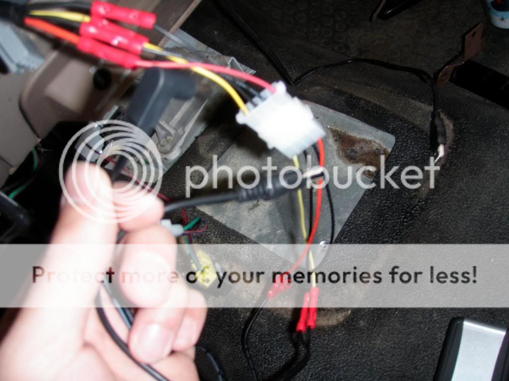

    Speaker wires running to the radio harness in the dash. Also, I tapped the IGN wire from here.
    I extended a molex connector from the M2-ATX to the front to power the screen and the USB Hub.

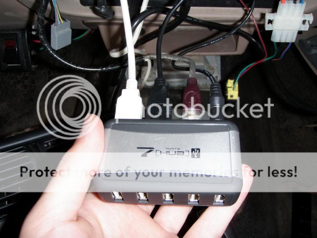

    USB Hub with screen and GSP plugged in. 7 ports.

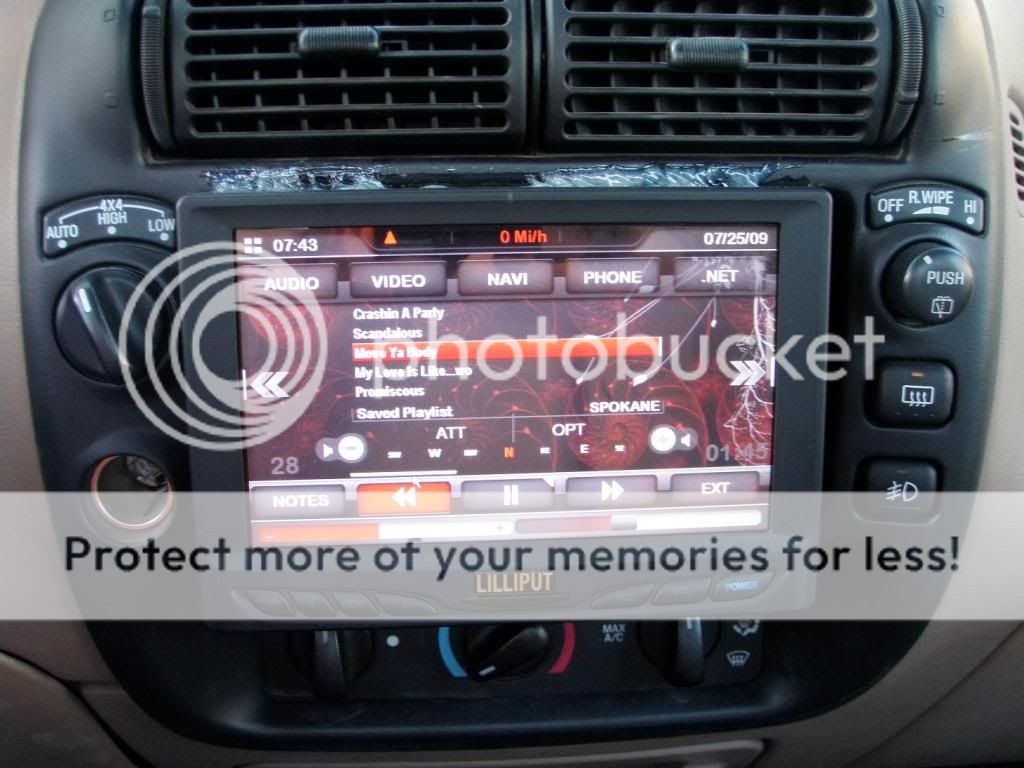

    Fired up!
    Ride Runner with LSX VOID 3.3 skin
