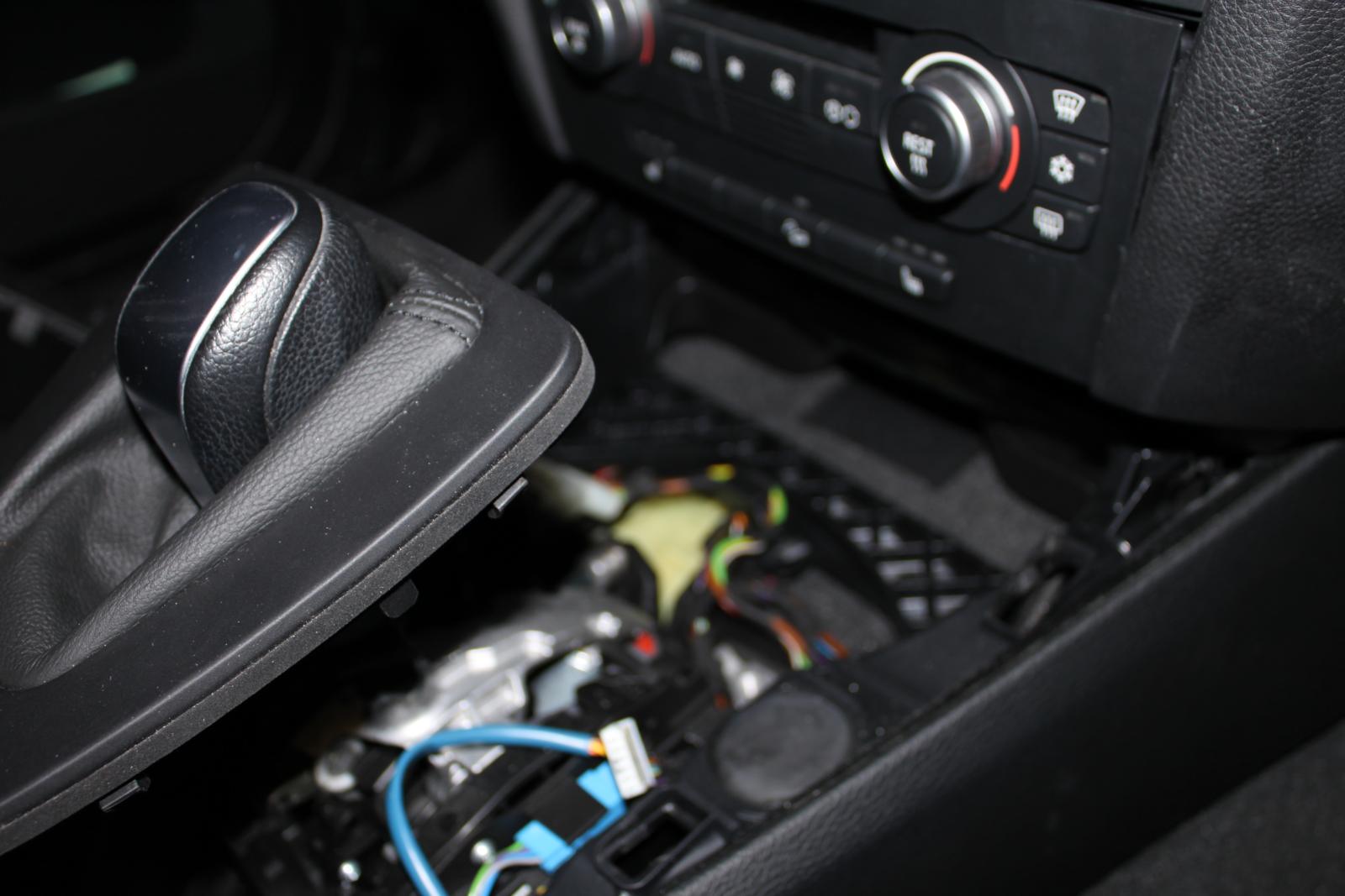

    I started off by taking off the front bezel and the radio/climate control bezel. The goal was to run the monitor wire down the center console, alongside the driveshaft and into the trunk.
    Sadly... I ran into an interesting challenge. The pics don't show it, but I was unable to rip off the radio/climate controls. I got the upper part of the climate control faceplate off halfway, and the rest just would not budge. An hour later and ten fingertips fewer, I decided to abandon this idea. This was reinforced by my (successfully) disassembling the driveshaft, and realising that ... there's no place to run the wire through it. Unlike the Subaru, which had a huge plastic case and cube-meters of empty space inside, here everything was compartmentalized. So ... I couldn't really find any space to run the wire. Doh.

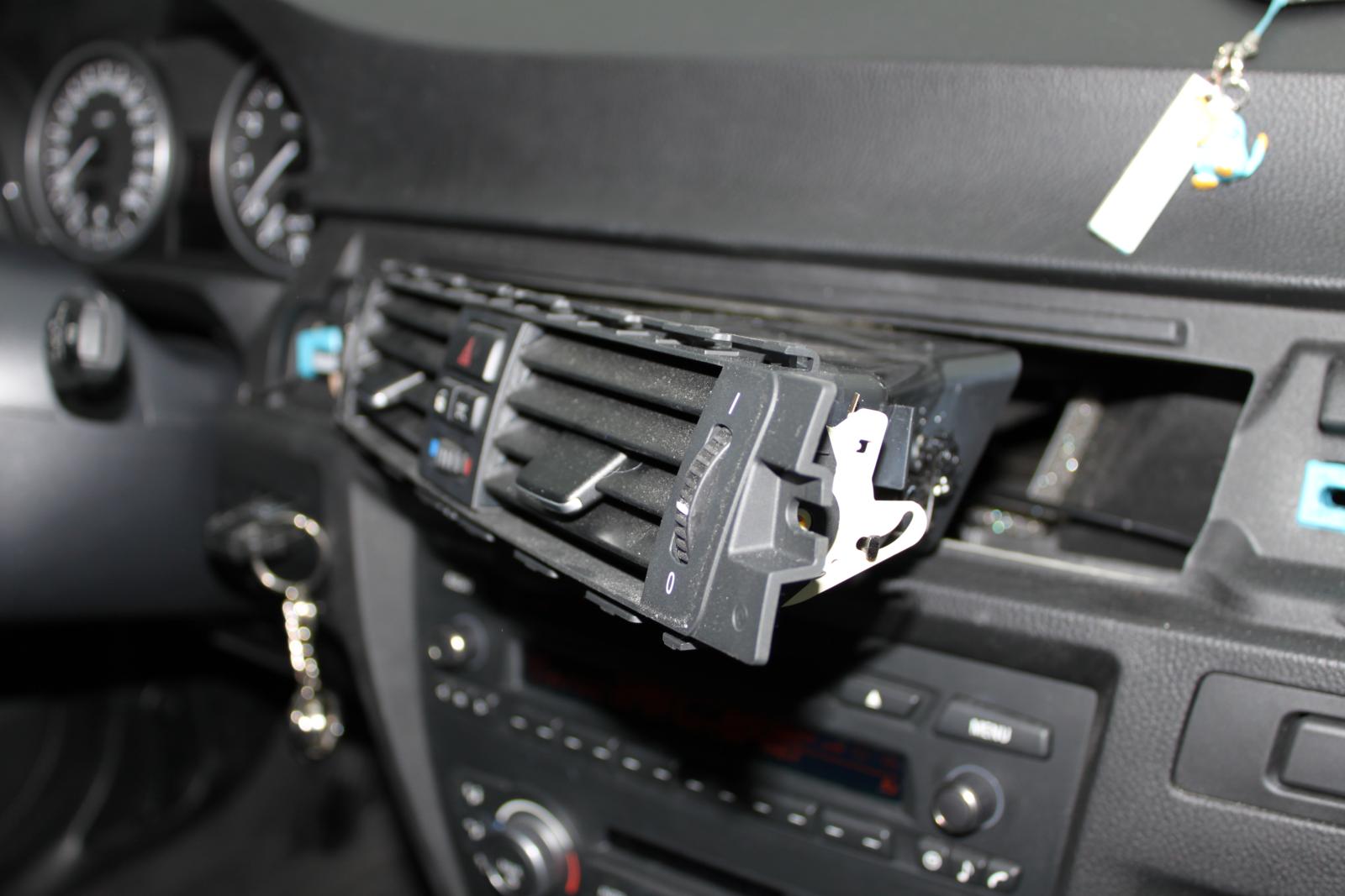

    So that's what it looks like with the wire sticking out and the aluminum face bezel removed. The weird black thing on the dash is the Cuda mount. We will return to it later.

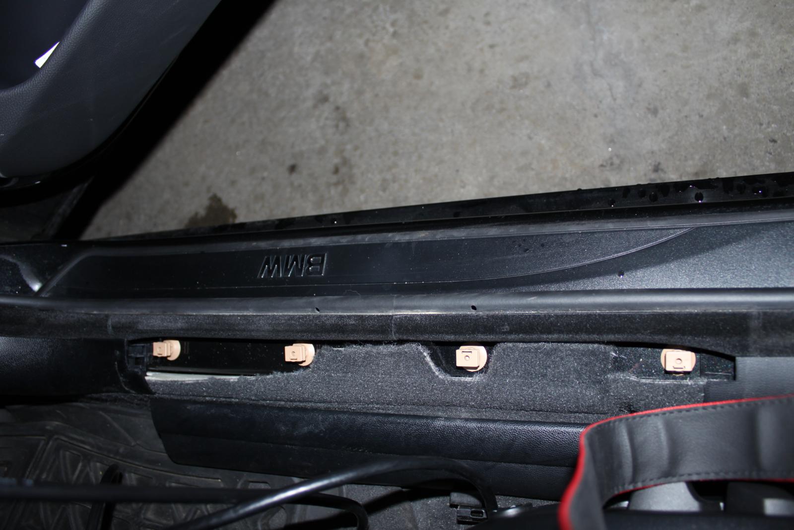

    I had three wires to run: ignition + (this is what is going to the fuse tap), monitor and USB. I also ran a wire that isn't connected anything - I need to install a power switch, and don't want to open up the whole car again. So the wires will go down this...

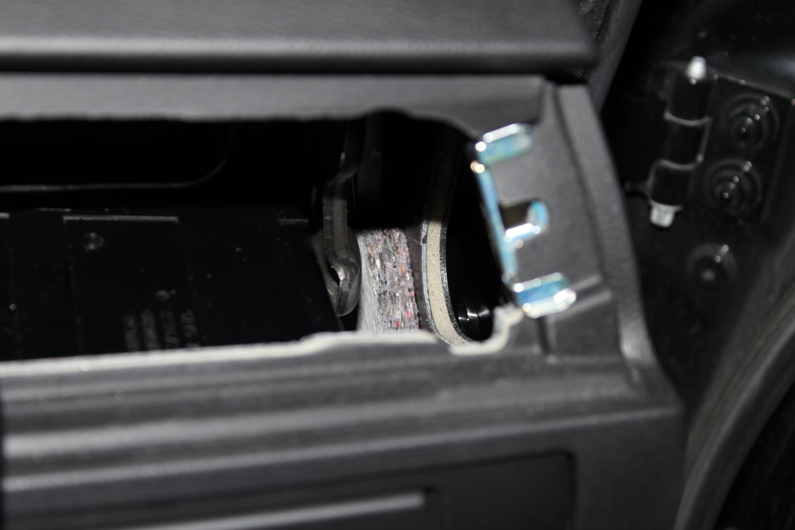

    (this is the view down the rightmost vent - notice the bloody TWO INCHES of sound insulation! and I thought my damn Dynamat counted for something)

    Along this...
    Along this, right past that relay is a hole that leads in the back to the trunk...
    And come out right about here.

    The wire is supposed to go from the rear of that centre console in the centre of the picture, underneath the carpet, out from under the seat, across and into the trunk. Yes, except the stupid carpet, in accordance with BMW building standards, is like 3 feet thick. Maybe slightly less but certainly not much less. And it's FLUSH against the floor. Sure, if I removed all the seats, I'm sure it would be removable (with a crowbar), but I didn't want to do that, so I tried fishing underneath it. An hour later and almost me giving up, I managed to do it. Other side came out from the center armrest, going into the AUX IN of the car:
