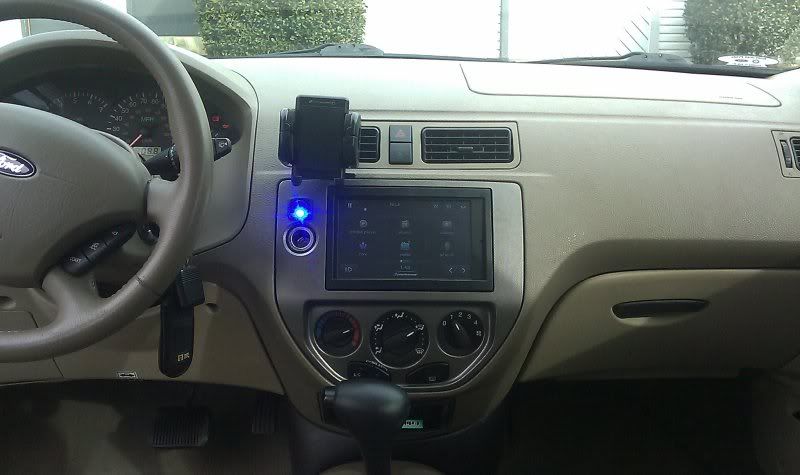

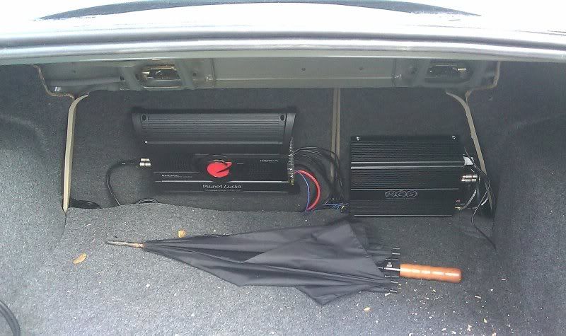

    Been gathering parts for a while, but I've finally completed my install. Still have to do some minor cable management in the trunk, awaiting the digital TV tuner to be delivered, and all the wires are ran for the reverse camera, but I'm still weighing my options before I drill into my bumper to mount the one I have now.
    Specs:
    3GHz Q35, Core 2 Quad, Mini-ITX
    2GB RAM
    500G 2.5" SATA hard drive
    DVD/CDRW combo drive
    In Dash Touch Screen Lilliput monitor
    WiFi b/g
    200W DC to DC Power Sup
    HQCTi AM/FM tuner to existing car antenna
    WinXP Pro
    CentraFuse 3.0 front end
    GPS Navigation
    Bluetooth Phone Support
    Media Player
    Satellite Radio
    Web Browser
    Audio Mixer
    OBD-II: Engine Diagnostics
    Rear Camera (not mounted yet but all cables are ran, just not ready to drill my bumper yet)
    TV Tuner (waiting on digital receiver to be delivered)
    SoundMAX Superbeam directional microphone

    very nice install! super clean.

      Working fine so far. I've been using one on my desktop for years. I mounted it between the steering column and the instrument cluster as it was a perfect size gap.

          I'm only using the mic... so far, no noise issues unless I have a window all the way down. Just cracked for smoking seems to not cause any issues with callers.

            Updated pix

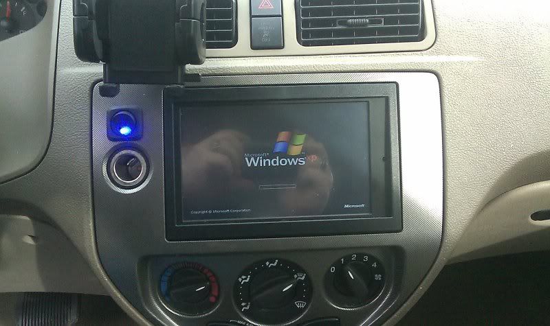

              That's where I have mine mounted, on my SVT Focus...
              Although I attached it using Dual Lock, and I think some vibrations are getting thu to it...need a soft mount.

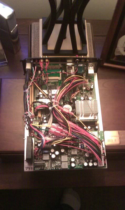

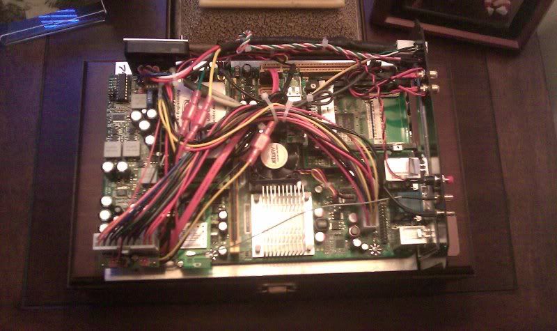

                  Since the original build, I've switched to the motherboard in the specs, NOT the mobo in the pictures. Info on it can be found here http://www.ibasetechnology.net/mi935.html
                  As far as running multiple apps, in the registry, I replaced explorer.exe with Centrafuse as the shell, so ALL it runs is Centrafuse and the apps therein. Before doing that, I had zero issues with running multiple apps as this is a hoss of a system.

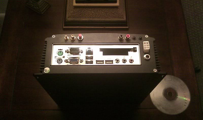

                      Is that the voom2 case? how is it on cooling that cpu? What tv-tuner are you going with?

                        It's actually a "Black Box Case" from Mobile Computing Solutions, which is a LOT like the Voom2, but seems to be a little more solid. Chris at Mo-Co-So has treated me right on everything I've ever ordered from him, so I always return to those guys for my stuff, though I do have more than a few items purchased here at the mp3Car store. Check them out sometime at http://www.mo-co-so.com/Black-Box-Mo...-p/mcs-bbm.htm
                        While the entire case works as a heatsinc, for the Alabama summers I took a small drill bit and drilled holes between the blades on the top, just above where the fans are located over the proc, then did the same around the power supply, then went back and touched them up with black model paint that matched the case color.
