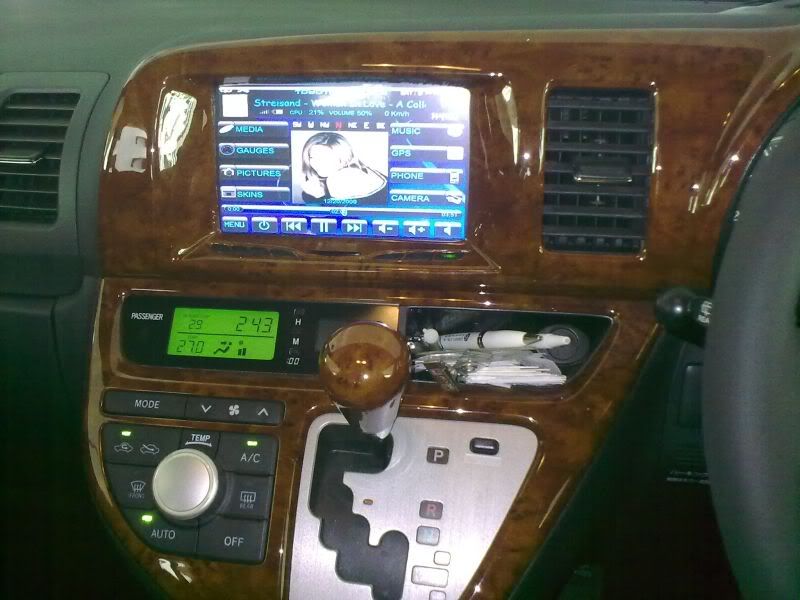

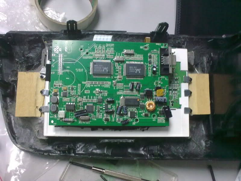

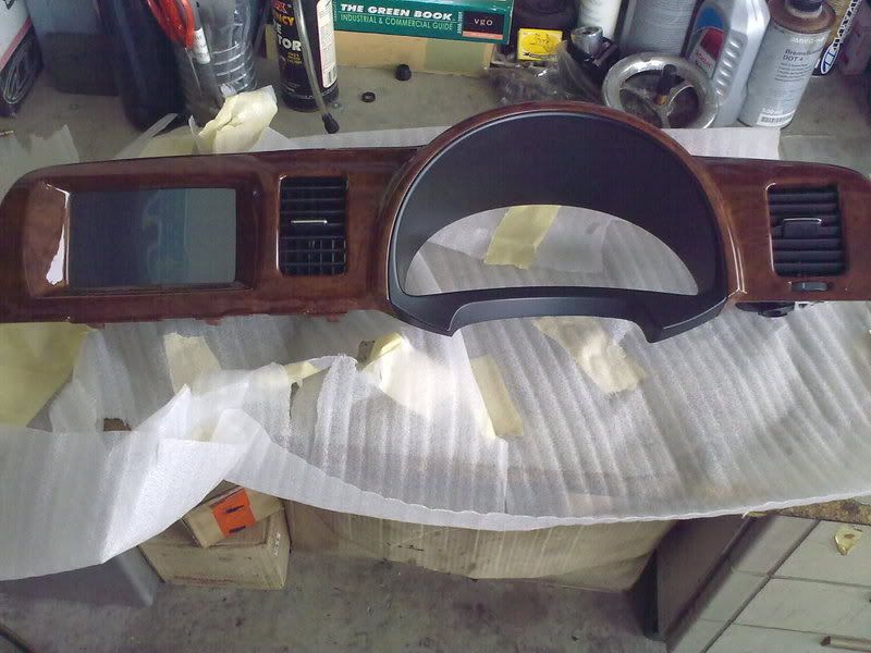

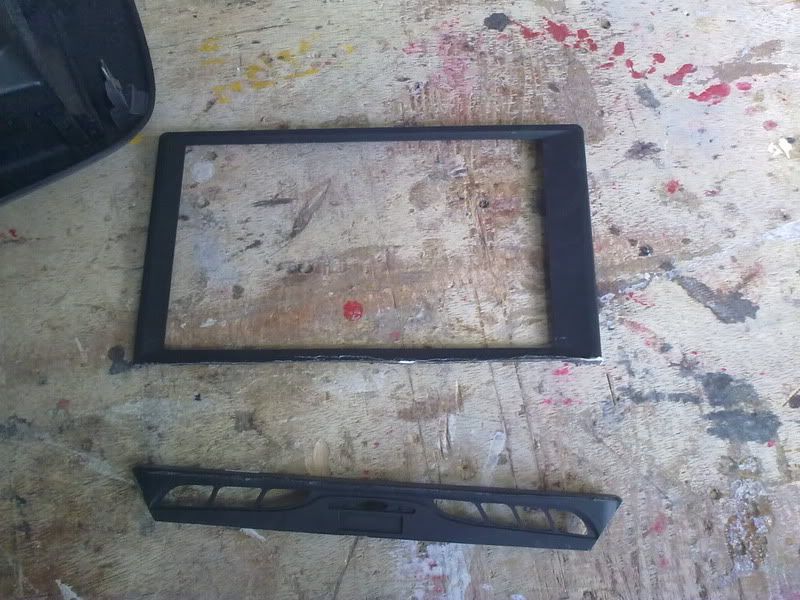

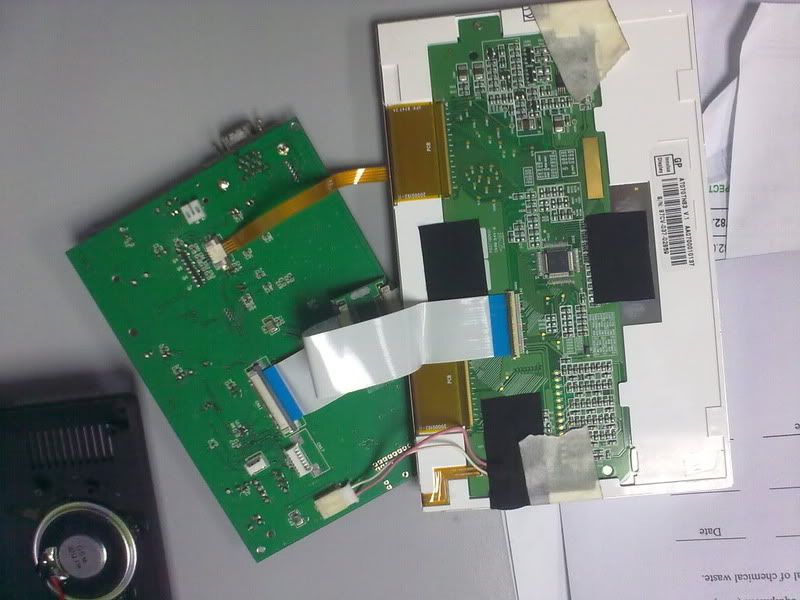

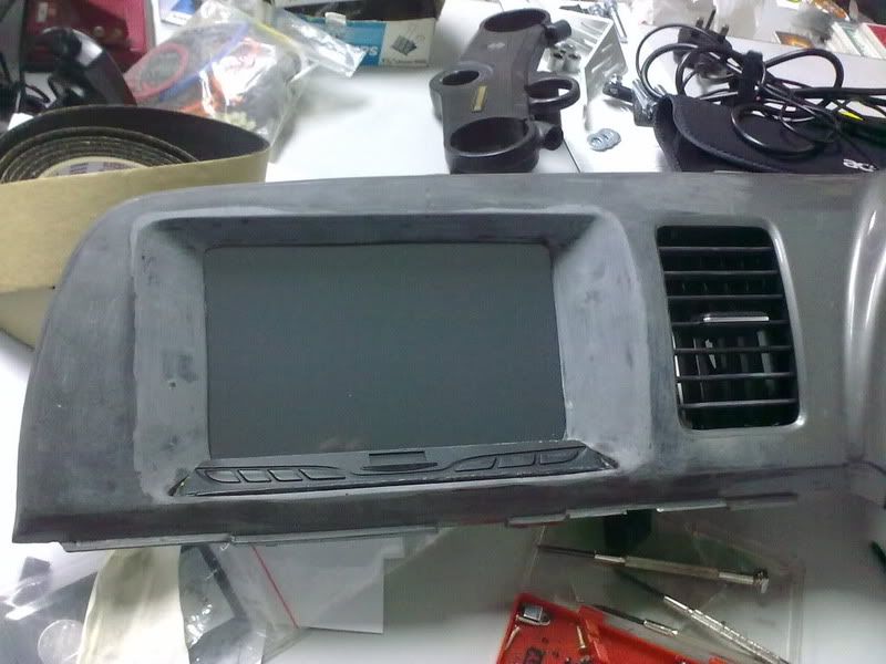

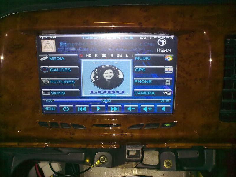

    This is my 2nd PC install & I decided to go for a more OEM look for my dash. The screen came from a ripped Lilliput 629. Part of the original dash was hacked & fibre-glassed to house the screen. The 629 original button panel was also fibre glassed to the dash.
    Picture of the 629 screen & dash painted in Walnut finish :
    Lilliput 629 dissected :
    Lilli 629 implanted to Dash :
    Dash with Original Lilli 629 Push Buttons :
    Screen in Dash :
    Intel D945GCLF2, Lilliput 629GL-70NP, GTop MTK GPS, Road Runner, DFX4, Winamp 5.13+Console+VST->HotAudio DAC->NXS 400.4 + NXS400.2 DSP Amplifiers + DSP Software Processing->Dynaudio 340 3 Way Active
