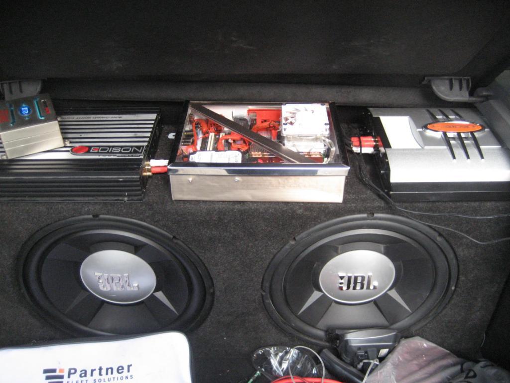

    In two years I contuniusly improved my carpc system. And I want to share the final steps of my carpc.
    My first carpc case:
    And insideof it:
    It was very practical, cheap and fast! A little bit big though!!
    And my setup was like this:
    As time passed I thought that my trunk got really really small so I thought at least I could earn the space that carpc occupies. So I made my second case:
    And at night:
