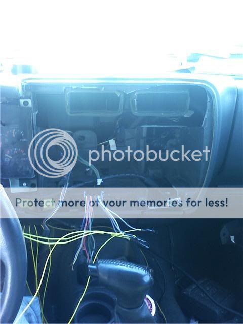

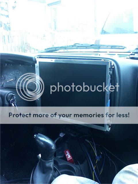

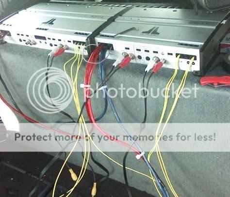

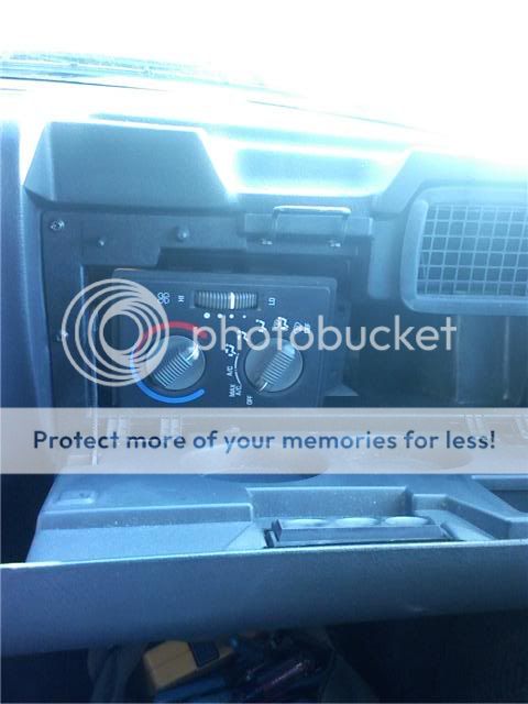

    Still have to create a bezel for my screen but waiting until touch panel kit arrives. Never done fiberglass before so that should be fun...AC Controls are in the glove box temporarily. If my Fiber skills are decent ill make a section under the screen down to the cup holders to mount them plus a little cubby for my cell and stuff. Did not take a picture of laptop in car since im waiting on a vga extension cable but planning on mounting it somewhere in the back near the speaker enclosure. Wires coming from sub amp to subs were temporary as well as the jumper from 12v+ to remote...just used to check system before finishing up and hiding everything...This is my first CarPC install and I enjoyed every minute of it...Im sure it will never be done though. Hope everyone enjoys looking at my pics even though they are from a cell phone. Any suggestions or questions feel free to ask...

      Thats a big effin screen!! Care to give us some details. Like where do you plan on putting your hvac controls? Do you plan on doing anything special on the software side?...I feel like with a touch screen that big you open up a lot of options.

        damn, and I thought my screen was big

                  any progress? also did your vehicle have an automatic 4x4 switch up by the vents? If so, where did you relocate it to. I have a GMC Jimmy which is practically the same exact car and I'm trying to decide where to move everything.

                    What did you use to get from RCA's from the pc to the amp?
                      1/8" stereo headphone jack to rca cable...my sub amp has a full range pass thru so you can daisy chain amplifiers. i went from sub amp to component amp
                        damn thats a big screen im jealous
                          Haha that's awesome dude! I ditched the 15" touchscreen i had mounted to my transmission hump area for a 10.4" Right now it's in a center console I made, but i was thinking about some kind of crazy dash install like that, but damn it's a lot of work! Good up to ya bro
                            That screen is HUGE!
