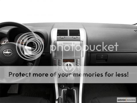

    And here is the stock photo of my dash will update when install is complete:
    Open to suggestions and recommendations, Im a busy person so time is only available on the weekends, and cash flow is limited so trying to find solutions that are both inexpensive (as much as possible) and still achieve my goal.
