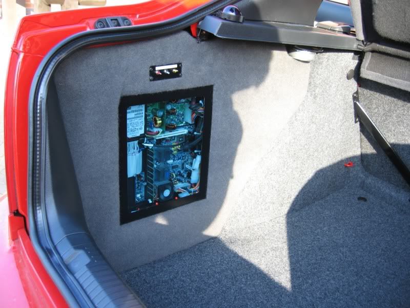

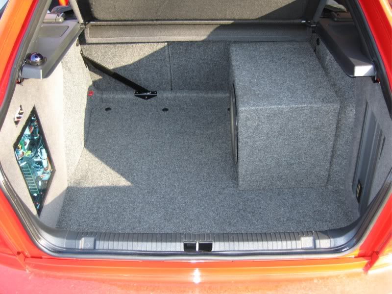

    The boot
    The PC

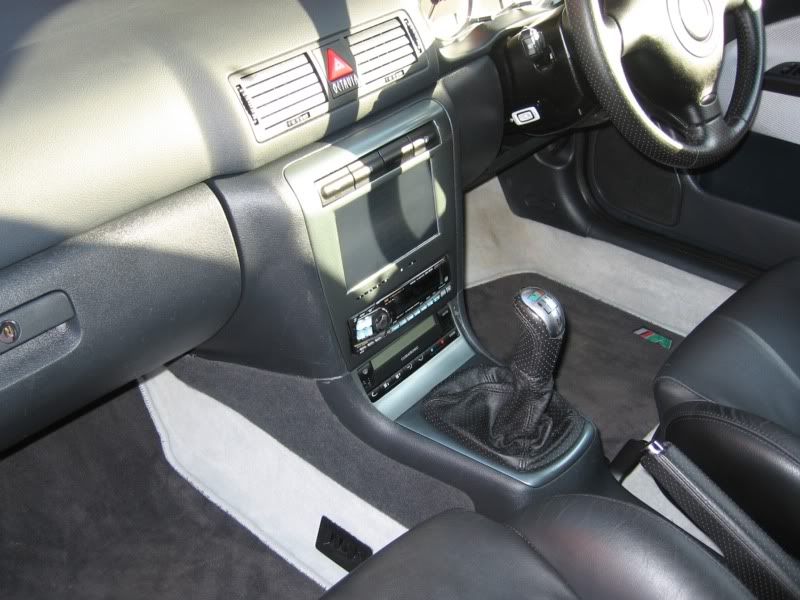

    The Dash

    Cant make my mind up if it would look better with a much brighter shade of silver for the dash
    Id love some suggestions on improvments

    i like your dash colour and those strut braces seem a bit silly!

        Very clean install!! Congratulation

                  Most of the PC built using a morex case
                  i removed the front panel and cut a hole in the lid lit and perspexed with a blue tinted perspex i had from an old computer case i had modified
                  Cut an MDF pannel to fit on the side of the boot.......... sorry trunk
                  Then trimmed it and fitted all the computer bits
                  the box to the left of the PC has usb ports on it with two 2 throw relays to cut the usb power when the PC is off
