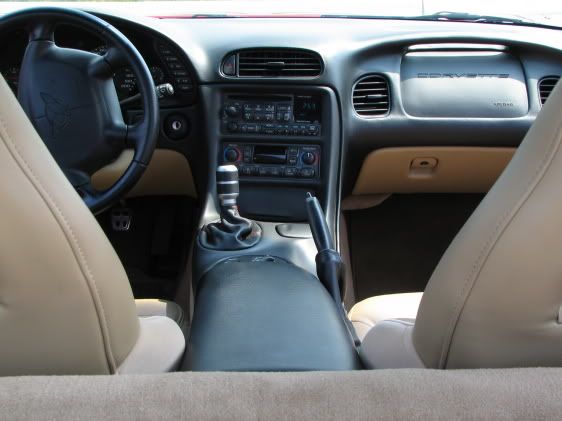

    Well, I finally got around to taking some pictures of my system. It has been complete for about 4 months and is working perfectly. I had pictures of the whole install, but the SD card in the camera got corrupted and the pics were trashed.
    Before :
    After (Yes, the shifter changed from a Hurst to a C6 Z06):
    Here are the specs :

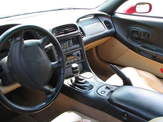

    I used the now familiar method of cutting the entire A/C part of the bezel out and sliding it down. Then mounted the Xenarc frame to the top of the bezel and gluing the A/C framework to the bottom. Then tape up from behind and fill in with the Oatey ABS cement from Lowes. I did not mess with trying to melt my own plastic. The cement was easy to use (get a sqeezie mustard bottle) and readily available. I cut the ashtray door down to half its size and used it to fill the hole in the bottom. My original plan was to mount the computer reset button and Sub level control there, but decided I liked the cleaner look better .. plus it's a great place to lay sunglasses. The sub level control and switches are mounted under the dash. After the filling .. then sanding, filling, sanding, red Bondo glaze, sanding, glaze, sanding, a high fill primer, sanding, primer, sanding, then the SEM Texture paint and SEM Clear finish. I covered up the buttons for the monitor for a more OEM look but extended the wires on the IR recever and placed it behind the grill of the internal temp sensor. Plus the Xenarc has auto turn on/off .. so I really never need the remote.
    To move the A/C Controls down, I had to cut out an aluminum support brace in the dash. A Dremel tool was EXTREAMLY handy for this and all the plastic cutting that had to be done for the project.

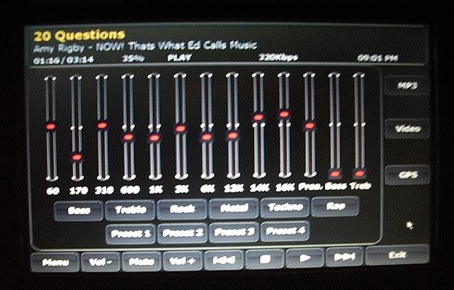

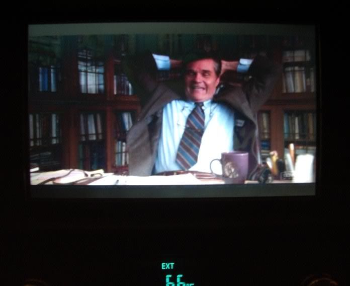

    The software driving the whole thing is Road Runner. RR is a FANTASTIC program written and maintained by Guino. It's free and there is a great support forum for it over at MP3Car.com. It is totally skinnable and there are many skins that have been created for it. I basically took several different ones and mashed my own together ... moving buttons and functions around. Here are some screen shots .. sorry for the bad quality .. time for a new digital camera.
    Props to the original authors of these screens (most from MP3Car.com)
    Right now, the hard drive has about 15,000 songs, 50 movies (in DIVX format), about 100 audio books, and a bunch of comedy albums .. and there is still over 100 Gig free. Song/album selection is very easy .. no mouse required. It is also possible to build playlists on the fly and shuffle at will. Who needs XM!
