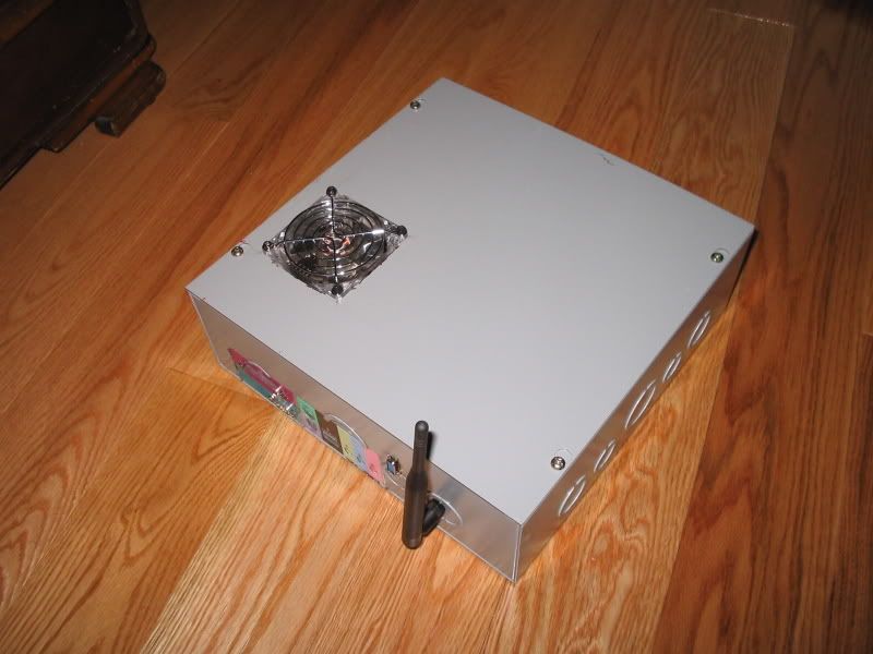

    The "custom" box. Includes 120watt opus DC-DC power supply, mobo, main hard drive, geforce MX440 (****ty but hell, I can play grand theft auto), 2.4ghz wireless (think its a dlink, whatever tiger direct had on sale that day). 4 port usb 2.0 pci card, which you cant see because it was installed after this pic.

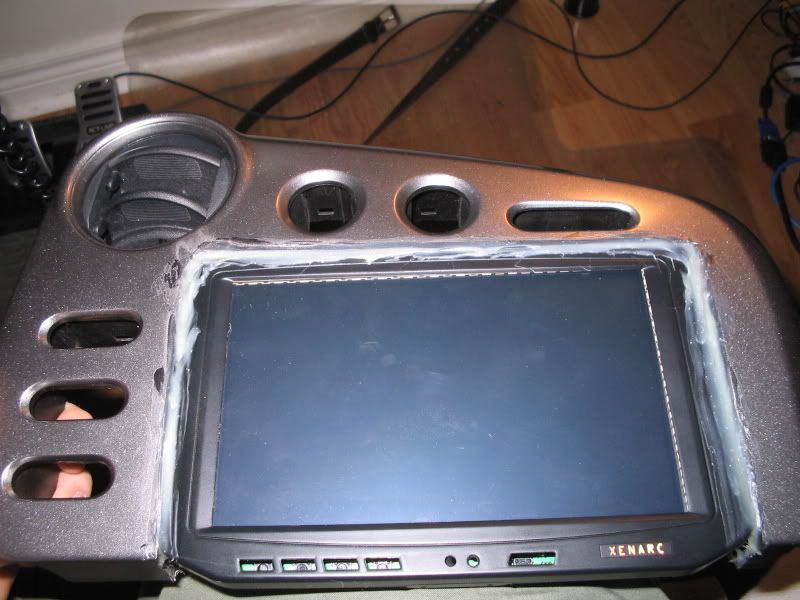

    The before picture.. The hacked bezel and epoxied screen.
    Bondo+ sanding+ time+ paint = not bad..

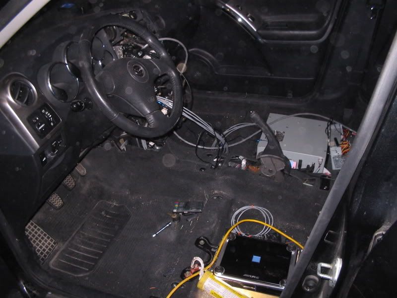

    Installation day... dirty lens... GF snapped it when I had the carpet back in.

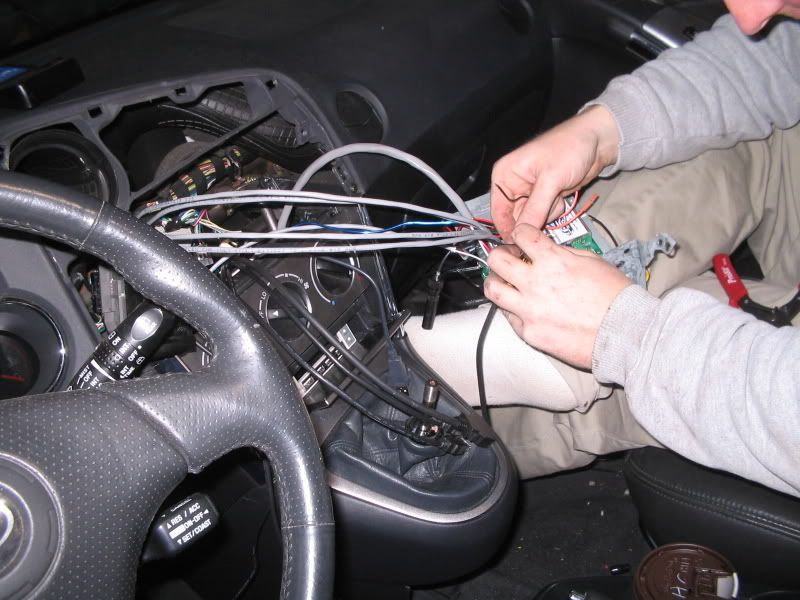

    More wires.

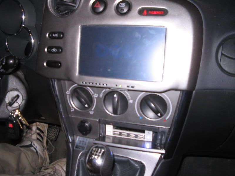

    More wires, notice the cubby with the DVD drive on top, and the harddrive/usb hub bay.
    Phidgets encoder... Volume ETC
    My just incase switch to turn it off. Ill be filling in the gap later...

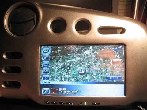

    A video showing streetdeck, my front end software. My friend made me that backdrop and the layout for the icons. I think he did a good job.

      Very nice! I have a question about street deck...are the maps 'satelite' views like is shown in your one pic? Could you take some more pics of the maps?
        AznRida: Yes I have the audio hooked up. I have a USB turtle beach audio advantage roadie hooked up to my alpine PDX 4.150 driving my speakers.
        LostAngel. Yes streetdeck has 'virtual earth' for mappoint. It requires an internet connection to download the satalite photos, so, if you were driving with no internet connection, you wouldnt have any satalite photos. It can be switched off. Im sure the Streetdeck part of the forum would be more helpfull for more questions.
