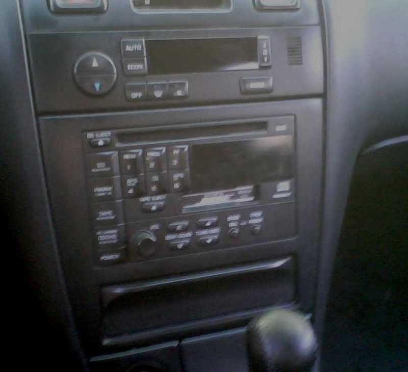

    and here's where it's going (cell phone cam, meh)

      Looks good, but I don't get the picture? That can't be what you want to do? There's no screen? Maybe I'm just being blond here
        ah, hehe, more late night posting with a bit of beer in me. Thats the before picture. Soon there will be a screen in there.
