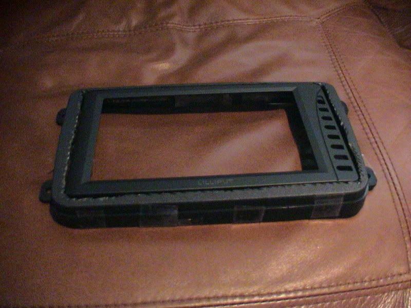

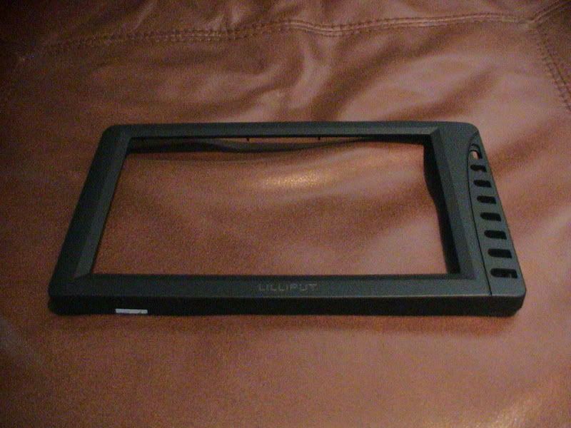

    I ran all the wiring and installed my amp today. Just gotta install the pc parts and hook it all up. I also started fabing up the bezel for my touchscreen.
    Break time

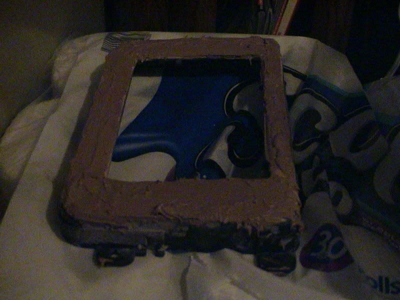

    first time using bondo, boy did it suck!
    well itll be done in a week or so and i can post more pics of my work.THANKS

                    bezel is done
                    i know its not perfect but im strapped for time and cant spend more hours sanding this thing. Ill give it another go in the summer when i dont have classes...
