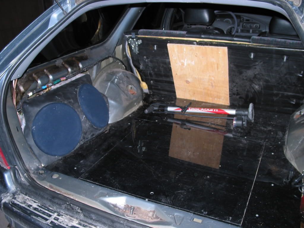

    my custom trunk, hiding behind the shrouds are to 10" perfects in my custom box, i have yet to figure out how to rebuild the trunk interior, i dropped the floor 3" to better fit my BMX bikes. i also swapped the interior out for the black one from my SHO, the seats are the best.

        the trunk:
        so a general whats what of my trunk, and yes i really do use my car, so everything has to be durable.
        1st pic of hidden noisemakers:
