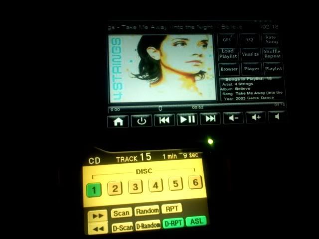

    CARPC SPECS:
    Aopen Mini PC MP 945 VDR
    120GB Western Digital SATA hard drive
    1GB SODIMM RAM
    Aopen Mini-PCI WiFi card
    Carnetix P2140 PSU w/ P5V
    Windows XP
    2 Vakoss 7-Port USB Hubs
    XM Direct Unit with Mp3car Interface w/S/PDIF Toslink output
    Visteon HDZ300 HD radio
    Xenarc 700TSV
    GlobalSat BU-353 GPS
    Ione Scorpion Mini RF keyboard
    TPMS 3rd Eye Kit with USB Interface
    AUDIO SPECS:
    Sound Blaster Audigy 2 NX
    AudioControl DQS (Digital Equalizer)
    AudioControl DCC
    Orion 8004 4ch amplifier
    Dynaudio MW160 component speakers
      Sirius SC-H1 Tuner
      Sirius with MJS usb interface and toslink digital out
      Sirius on Road Runner
      XM on Road Runner
      Ione Mini RF keyboard

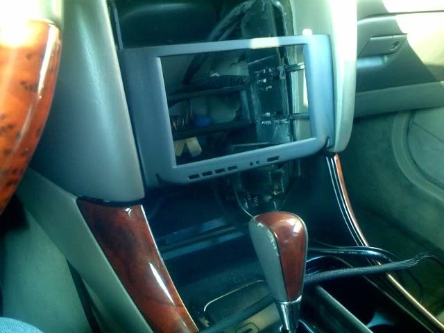

                    rgarjr, how did you mount the pc? I just started my project on a '99 GS300. I bought a VOOM case, but i'm thinking about creating something myself so that I can mount it in the space where the 6disk change is or to the righ of that.
                    Thanks,
                    Vince
                      Well you're gonna have to remove your 6-disc changer if you wanna mount in in that area. I mounted mine to the right of it at first, but then i decided to remove the changer since i wasn't using it and made more room.
                        Thanks! That is what I was thinking as well. I don't use the changer. Did you create a custom enclosure for the pc components or where you able to find a case that would fit in that spot?

                              hey great install, i was hoping to do something similar. Where did you get your bezel?
