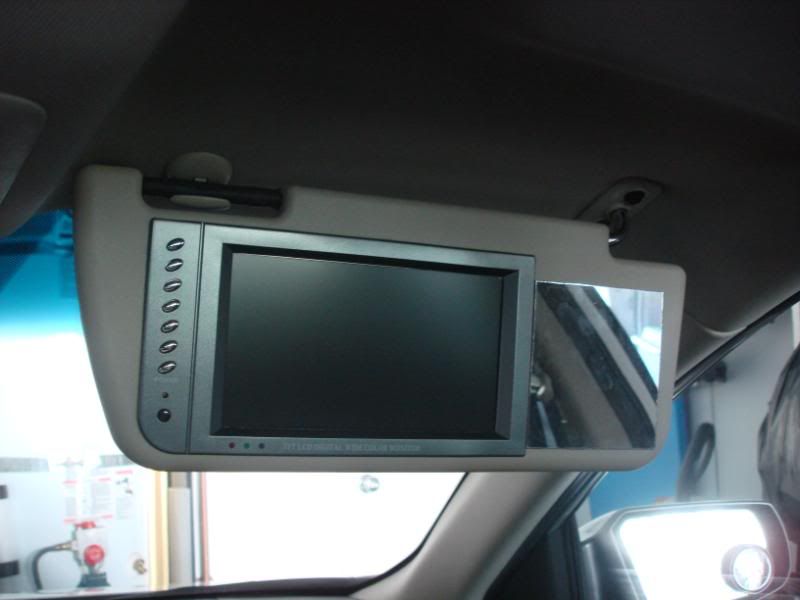

    When I originally started with the car...I went with a Luxma Visor monitor on the passenger side and ended up putting a Playstation 2 (slim) in the glovebox. Pictured below.
    I will be keeping this setup but I may remove the visor monitor as it is a pain in the butt and the computer monitor will be mounted on the headliner just above the map lights. The space is approximately 4.5" H x 9" wide at the narrowest point which looks to be perfect for the Xenarc 700YV touchscreen Location pictured below:
