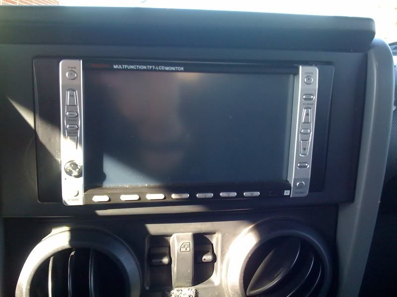

    -- I have had problems with the touch head unit
    1. The fans in the head unit are extremely loud.
    2. The unit changed modes sometimes after hitting a bump.
    3. Sometimes the unit will not turn off. Even after shutting the car off needing a swift beating into submission to let it know who's boss.
    4. Sound transfers to different speakers making it louder for different sides and spontaneous times. NOTE: This could be due to the fact that Best Buy is a terrible company and gave me a bad harness but thats another story.
    UPDATE 1JUNE10: Removed *****y touch screen head unit re-installed factory unit. Ordered EBY701 and replacement top dash from 4WD.com part #DAYKJ71020 pictured below

    This is a pic of the stock head unit.
    The crappy touch screen head unit. This unit is a CID 650.
    NEVER BUY ONE!!! THEY ARE GARBAGE!!!
