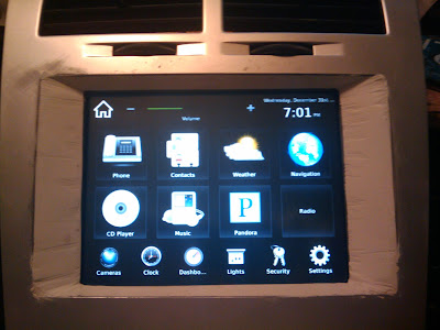

    BestBuy Infocast 8" touchscreen, custom firmware, flash frontend.
    This build never got past GUI design, and I was spending far too much time on the UI and not enough on the backend to run it.
    Third revision:
    BestBuy Infocast 8" touchscreen, custom firmware, remote desktop client.
    Dell D420 Laptop
    Modified Dell D-Port Mini-Dock (Added remote power header, USB WiFi accesspoint)
    DCDC-USB Powersupply w/ Dell specific plug from a universal powersupply (has the ID chip)
    Sony head unit with Bluetooth
    I'm running WindowsXP, RideRunner, Garmin Mobile, and Pandora. I added a RaLink WiFi adapter inside the D-Port, and SoftAP drivers for XP. The touchscreen (I plan to add a second one for passengers) connects to the laptop via the SoftAP network. On the touchscreen I'm running the stock kernel from chumby and Ubuntu 9.04. For controlling XP I'm using rdesktop which is an RDP client. I'm still building a controller to interface the sony unilink bus to the laptop for control & status, and to enable the aux input on the back. The controller is based on the Propeller chip from parallax, and will also handle talking to the two ultrasonic rangefinder "parking sensor" kits.

    I also have to finish bondo & paint on the dash insert before it can be used.
