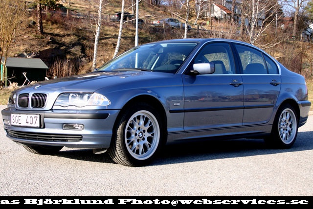

    This is the car that I'm about to install everything in:
    It's a BMW E46 325i. Completly stock except that I replaced driver and passenger seats for sportseats.
    I will remove the stock headunit and put the screen in it's place. Computer will be installed in the trunk in the 'expensive corner' i.e. driver-side corner of the trunk. The AMP will be placed on a fabricated panel above the spare tire.
