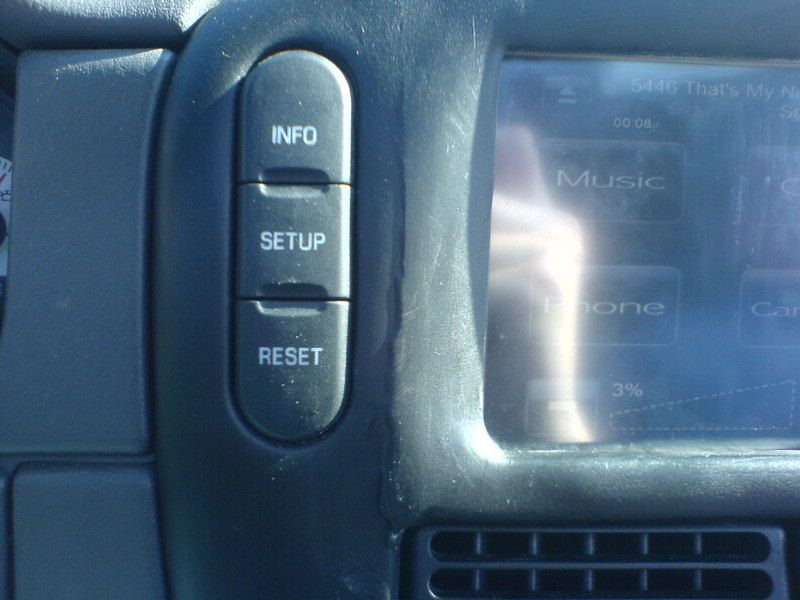

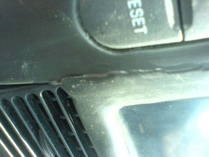

    i come out to my car the other day to see this:
    im going to sand it down and maybe do another layer of bondo and then paint it. my question is what should i prime it with so that the paint that goes on the bondo and the paint that goes on the plastic looks the same color. and what would i cover it in when im done so this wont happen in the future?

        It's not melting. Filler material is suck. It doesn't stick well to the dask trim and separated/cracked.
        It happen to me too and I have to redo it with better filler and a little more knowledge about the products I learn over the years.

              I would suggest you read the very first sticky in the fabrication section concerning product choices for bonding to plastic dash parts. In addition to the Dynatron product referenced in the post, you might try a product by Dominion SureSeal - they make a variety of plastic bonding products that range from very flexible to rigid. I have had very good luck with the Rigid flex bonding agent & filler - XRFNTR material. Has a long work time (around a half hour), but slow to dry (12-16 hours). Once dry, it can be sanded, filed, etc. It's what's holding my Xenarc housing to an OEM dash pod made for a nav system. Takes the FLorida sun/heat (black car BTW) with no problems so far.

                  i didnt use filler of any kind. thats all light bondo and fiber glass bondo and my bezel! i have no idea how it happened i just thought the bondo melted.
                    Maybe there was a substance on the bezel like oil or gloss or something? Did you use the right hardener? Enough hardener?

                      Well, Bondo isn't a product. It's a brand name. What you use is a lighweight body filler and fiberglass reenforment body filler. According to most people in the auto body industry, Bondo brand body filler is just suck.
                      Look up TurboCad thread on the material he used. http://www.mp3car.com/vbulletin/fabr...ory-bezel.html
                      Personally, I would use plastic epoxy to glue/attach the 2 pieces together and use flexible bumper repair as a filler. I use SEM brand because I can get it locally and it come in a smaller size that more than enought for 2 jobs (SEM 9 bucks for 1oz vs 3M Automix 30 bucks for 5 oz). In the sense that 3M automix is cheaper/oz but you don't need that many.
