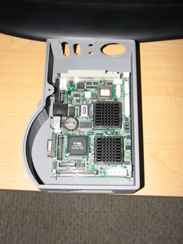

        The motherboard is a 3.5" SBC, or the same size as a standard desktop hard drive. The board has a CF slot on the back where I have a 4GB CF hard drive (actual spinning drive, not flash memory) tucked in there. The power supply was going to be a bit big for the case too...
        Some printers make the models out of dust and cure it, others use a wax type substance, but this is good ole ABS plastic, can be sanded, painted, etc... Not sure what the materials cost...
          This is the underside of the motherboard. The bright orange strip you see is the back of the hard drive
