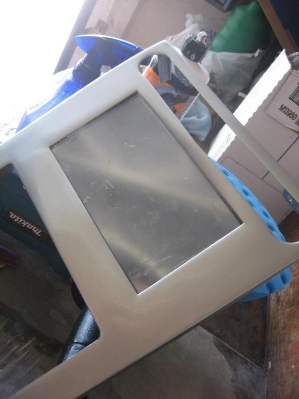

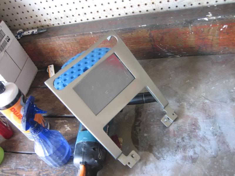

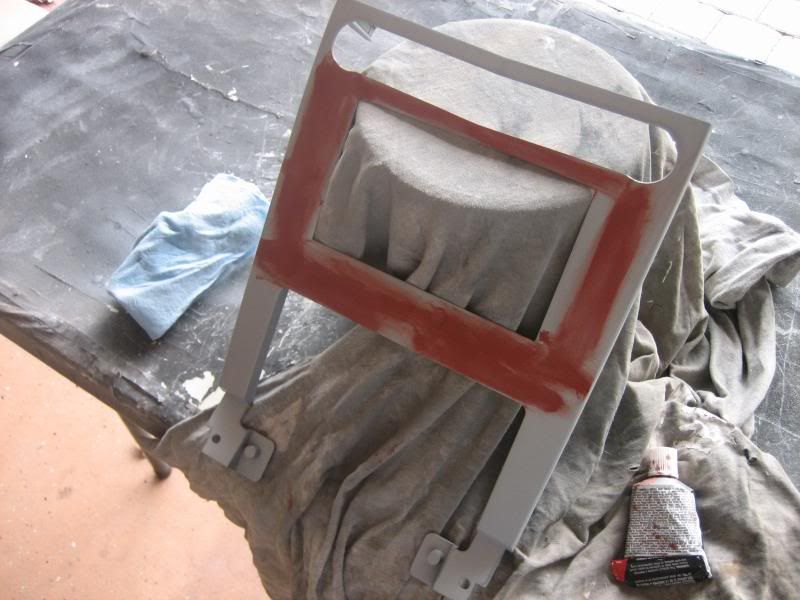

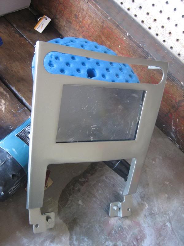

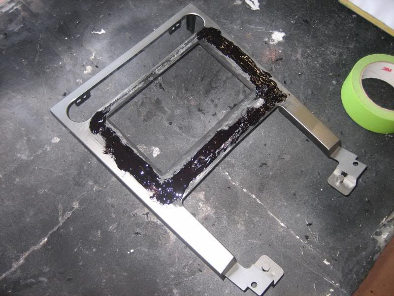

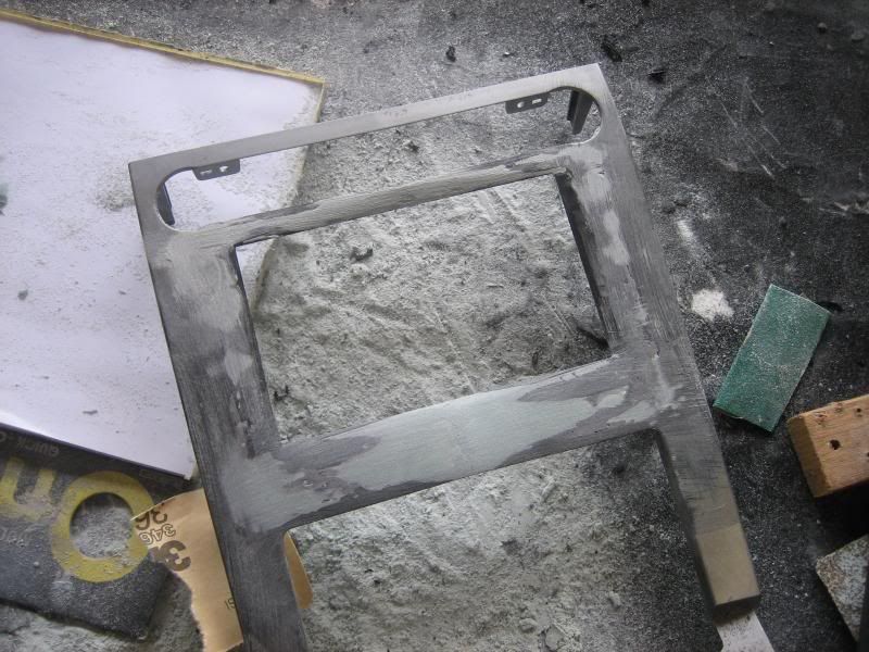

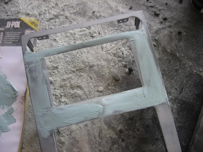

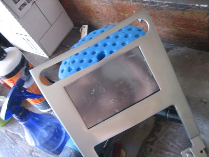

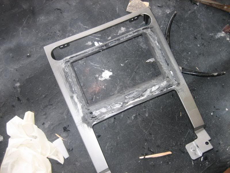

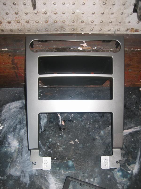

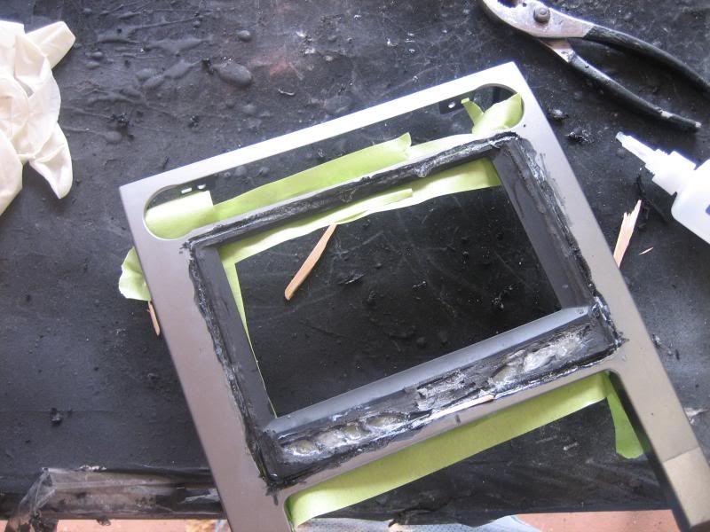

    Here is a Maxima Bezel I did for a member here

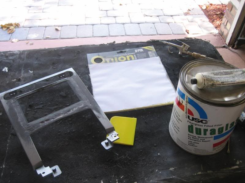

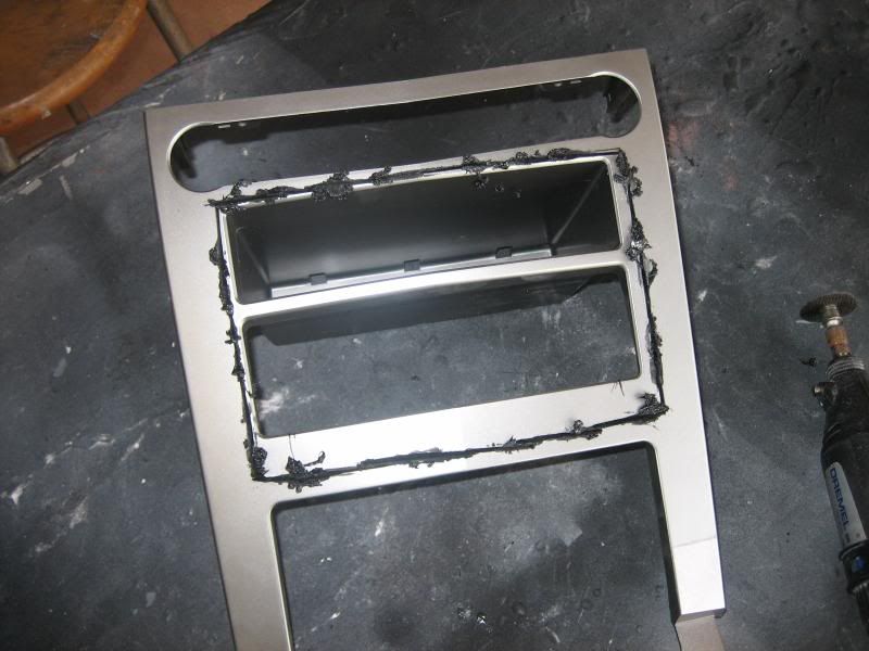

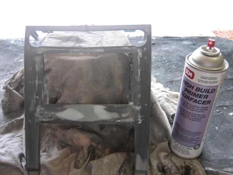

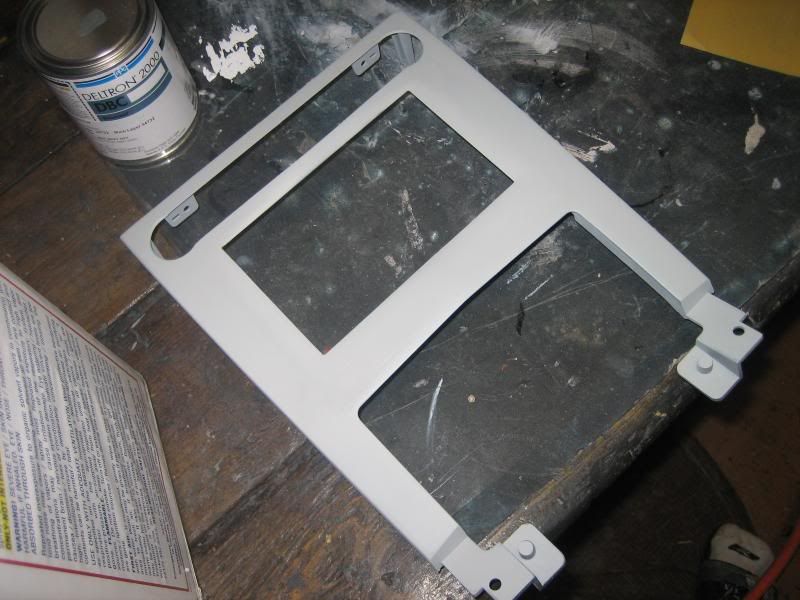

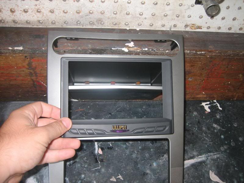

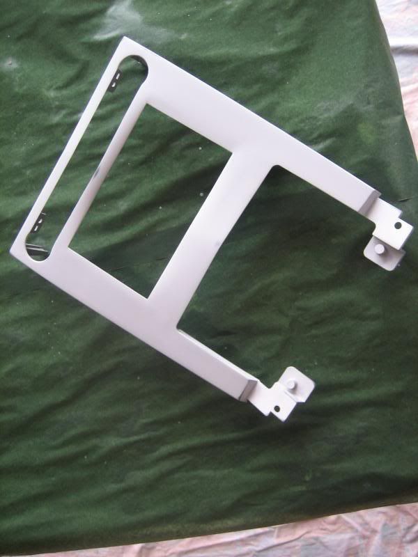

    I molded in the bezel into the Metra kit for this car. We did the best we could on the color match. In the final few pictures you will see basecoat, then clearcoat. I toyed around with the basecoat and clearcoat for a long time. The original factory finish is sort of a brushed aluminum. In the end I did a little wetsanding and buffing to try to get it as close as it is going to get. It came out pretty clean. Don't mind the loose screen. It is a junk screen I have laying around, for test fits, etc.

    Lookin' good. I see they haven't changed that bezel much from the 2004 I have.
      Still the same bezel, that is good though, easy to work with. The only thing is that the sides are not equal widths.

        I like the color too. Looks similar to the color I just finished mine in.
        I used Rustoleum Universal Advanced formula "Titanium Silver". It's a really neat paint finish by itself, but a little too flashy for inside the car. After a few coats of that and letting it cure, I covered it with 2 coats of Matte finish which gave it a nice aluminum look.

          Wow, yours looks great as well. The paint really came out nice.
          The bezel would not change much as usually cars dont change style (generations) until every 4-5 years. This was actually for a member on the forum.

            Thanks The old dash finish was in a brushed stainless steel, but I like this much better.

                  seems like it could have used some more sanding. Still have some lumpy stops
                    I think he reworked everything once more before he sent it out to me.
