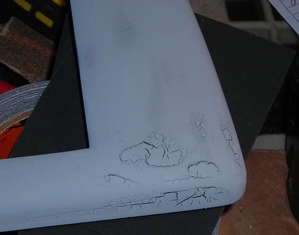

    First problem is that the primer I'm trying to use is not working out. But its not a big deal since the paint I'm using for my final coat says it doesn't need a primer. But I just thought it was weird and wondering if anyone can tell me why its doing it.

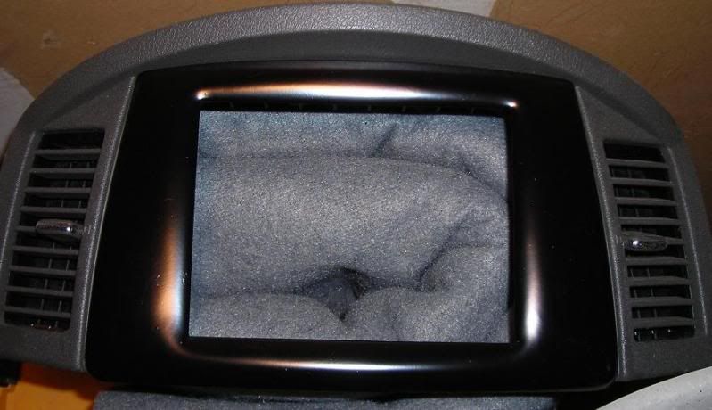

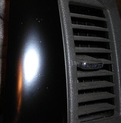

    But my real problem now is that when trying to do the final coat it keeps getting ruined by dust. I can't really paint it anywhere but my garage because of ventilation issues anywhere else... Any tips/tricks to keep the paint from getting ruined by dust? (I'm using that Fusion paint, satin black)

        Make sure that the paint you are using is based for plastic. If not... Chances are that it heats up the plastic while you apply the paint, and deforms the top layer of the plastic when it cools down again. (I had this problem, when I tried using metal paint on plastic parts).
          ^^^ This is meant for exterior automotive finishes on metal, it's not formulated for plastic at all, that is why it is cracking.
          Pick up some fusion plastic primer and you should be all set.

            I'm using this paint in satin black. It says it doesn't need a primer. Do you guys think I should still go out and buy a new primer to use? Or just do a few layers of paint. (I did 3 coats in the pics above, I think it turned out good overall except for the dust)
              you can also consider a textured paint as it will cover those specs up. high gloss paint is very hard to hide any imperfections.

                        Dust is usually un-avoidable, which is why we can buff them out in the clear coat. You should be using SEM products because they dry within second so no dust forums.

                          Oh, and as for the primer, it should go on smooth, either you are putting it on way to thick or the surface underneath is wet.
