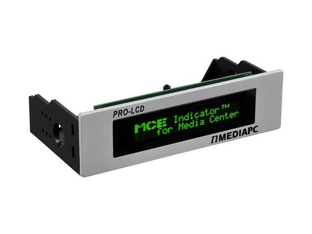

    but then I found this:
    http://www.newegg.com/Product/Produc...82E16811996005
    and if I could integrate that into my fact play it would surely look OEM

    Why go through all that trouble to get a 2 line character display? That's ludicrous. If you are putting in a CarPC, do it right!
    1.9in x 2.9in -- 47mm x 73mm
      I am doing this because its Custom and fun, but how do I "do it right" by your definition?

            Well the part that you interact with the most is the screen. Putting in a VGA touchscreen allows you to fully utilize the CarPC, and can look OEM. GPS is near impossible with just a character display. Frontend navigation would be a bear. Just so much nicer to have a real screen.
