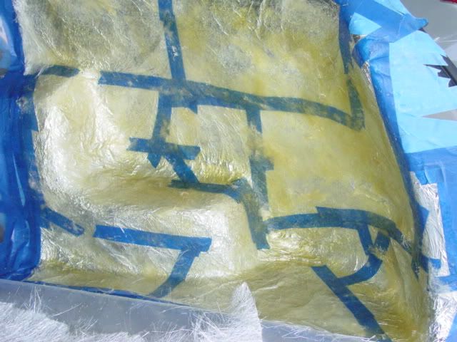

    Okay, here is my geto first time fiberglass sub box for the Matrix.
    Well, I want to thanks to all those who share their work and idea.
    Tutorial start from here http://web.njit.edu/~cas1383/proj/main/ and http://www.ajquick.com/cars/tutorials/fiberglass.php
    Thank pcmofo for the newbie boost
    Material from Lowes and Wally world.
    Tape the darn thing down.
    First layer
    2nd layer
    I skip taking picture after 2nd layer cuz it's really messy and I don't want to screw up the camera with my sticky hand.
    Here is the final box. Front and back shot.
    5 layer of mat + fleece.
    6 layers of mat + foil and tape
    Okay, it my first time every play with FG and could be the last. There are may bubble, but that okay as it a learning experience. I think it's strong enough because when I stand on it, it's safe and sound .
    Now, all I have to do is cover it with carpet. I was going to use left over fleece instead of buying carpet. What you guy think? Is it a way to go or doesn't mater and use what I have. I want fleece cuz I already have it and the color match with the back interior.

      6 layers is plenty strong, i wouldnt worry about that. Before you cover the front with carpet or fleece i would add some bondo to the front and smooth it all out, the surface looks very bumpy. as for using fleece instead of carpet...you can try it. if it looks like crap, then pull it off and use carpet.

        mmm fleecy soft sub enclosures.... i have to express my agreement with sciontC here... give it a little filler, a little sanding. life will be better with whatever goes on top of it then.

          Good work matrix. I got air bubbles the first time I did glass work, it turned out fine as long as you have 5+ layers, and not every layer has bubbles. I'd reccomend putting some deadner around/ in your box.
          But again, really a great job for your first time!

            Yup, Lowes has Elmers instead of Bondo resin and price is the same at Lowes vs Home Depot.
            Anyway, thanks for the tip.
            I end give the box a layer of light weight body filler (Bondo). Cuz I already had that stuff sitting on the shelf that I bought when I did the fab on the Supra and Matrix.
            Okay, so should I have the box a coat of primer or just adhensive spray and carpet/fleece over? I don't want the adhensive spray soften the Bondo filler.

              the adhesive won't do anything to the bondo. the only time you really need a primer is if you're going to be painting, or you're just trying to get the surface mirror smooth. in either case, if you've got your surface reasonably smooth with the bondo, you're good to go for fleece/carpet.

                get the super 77 spray adhesive.
                It's the best out there, bar none.
                Re the fleece, I'd use carpet if I were you.
                The fleece won't stand up to the abuses in the car as well. Things hitting it, snagging it, catching it, etc. Carpet won't wear as quickly.

                  ever played with Super 90? I think unless you're doing arts & crafts, it's the way to go. Holds like a motherphuccker.

                    Thanks guys/gal. I already pickup 16oz 3M Super 77 from Wally world for 9 bucks.
                    I used the can make by Loctite? before and it's okay but not the result I expected. I read that lot people use Super 77 for car's roof/ceiling so I assume it good to hold the carpet.
                    Anyway, I just use a fleece for now. If that doesn't hold, I'll go with carpet. I choose fleece cuz I already had and match the color. As for it being beat up is not really a concern cuz I tent to take good care of my car. The only thing that often in the back is the stroller and/or a a box for groceries.

                      Fleece sucks for a finishing material. Everything sticks to it and it looks real bad when you try to vacuum it. Go with carpet or vinyl (vinyl will require an additional layer of bondo and some sanding).

                        All done. Well, almost
                        Almost there
                        Carpet/fleece I mean. Because the trunk is plastic, I have to cover the back of the box as well.
                        Test fit.
                        This test is a must fit.

                          aww it's so fuzzy and cute! Looks like a cloud of bassy goodness.

                            Looks great!
                            Play with it, 'til it's broke.
                              Good thing it's covered in something soft. That way when you're ruining your kid's hearing it won't scratch up his stroller
                              PS: buy a grille. I know you think you're careful and everything but the first time you're loading that stroller in a downpour, you'll be happy you did.
