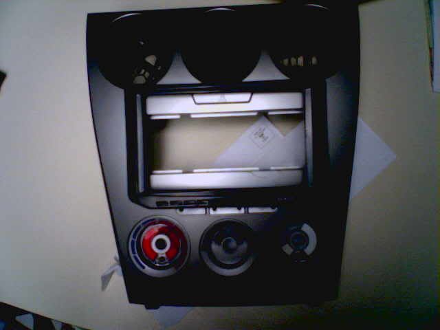

    Well this was my first attempt at any type of (major) fabrication and I'm pretty happy with how this came out. I had the Metra kit for the Mazda6 and decided to mold an Xenarc screen in. However by doing so I also had to relocate a few buttons/circuit boards which is still a work in progress. Nevertheless, more pics to come of the completed job. I'm glad I took this job upon myself as I can use it a building ground for fiberglassing my own box in the future.
    The idea:
    In progress:
    All primered up:
