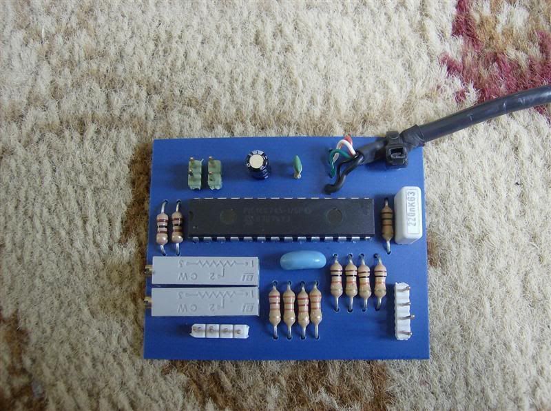

    Anyone have one of these? The website totally lacks any useful information.
    The device I got (Thanks Kalt!) has no markings on the PCB...
    The new model DOES have markings...I'm assuming the pinouts are the same?
    2 analog inputs with 2 grounds, 2 custom pins, IGN and voltage sense...
    I'm also assuming the pins next to AN2 and AN1 are the grounds?
    But what are the two trim pots used for??
    Also, when the device gets a signal, and it sends an output to the PC, how do you tell it what output to have? I know it's easy binding hot-keys in CF, but I gotta know what the device is outputing to configure that!
      Each trim pot adjusts the sensitivity of the analog input, that way you can have button separated by lower resistance. Those are ground pins next to the analog pins. Let me know if you have any more questions

        Thanks Kalt...
        I guess I can open Notepad when I want to config the outputs, see what each one does, huh?
          Originally posted by WuNgUn View Post
          Thanks Kalt...
          Yep, that's what i did.
