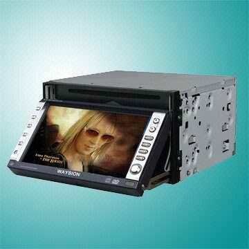

    I'm looking for a 2 din lcd with dvd/cd player.So that I have access to the cd slot up front.
    Something like this:
    Now, I want to connect that to a computer and use something like RoadRunner.
    But I'm not sure what kind of connection that can communicate with my car pc with touchscreen?
    In the specs, what MUST be there to make this work?

    You want a monitor with a VGA input and a USB touchscreen. Currently there is no product that meets your wants in the formfactor you want.
    How about the Wiki?
      darque is right
      i've looked into the same thing, all of the double dins like the one you posted, have drives in them, mind you they only play dvd's cd's, and you cant output the touchscreen control (unless ur an engineering wiz)
      so, ur kinda stuck for now, and 2 of the Infill units are around $2000 (or will be), the cheaper of the 3 is still around $1500 :/
