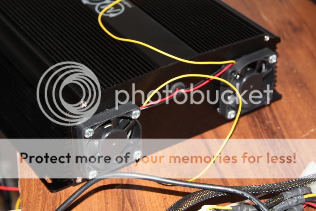

    MY NEW Case from Mobile Computing Solutions(Modified by me for better air flow)

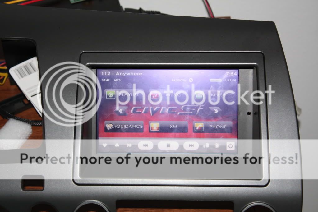

    New Dash Piece
