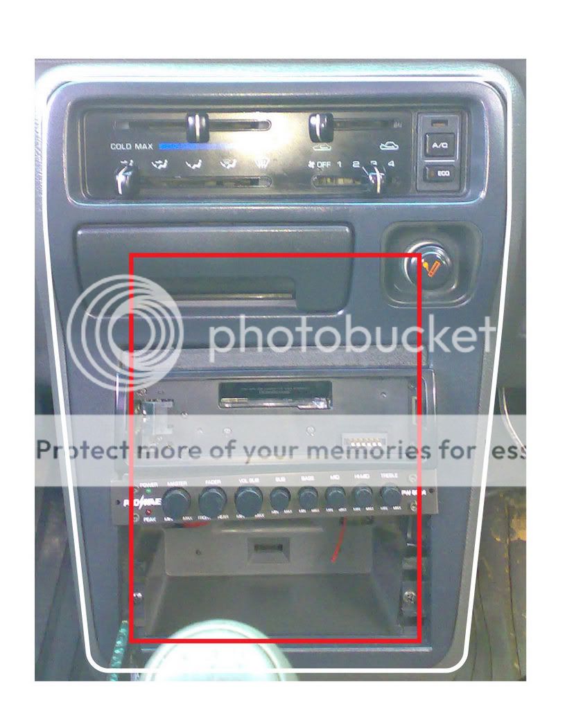

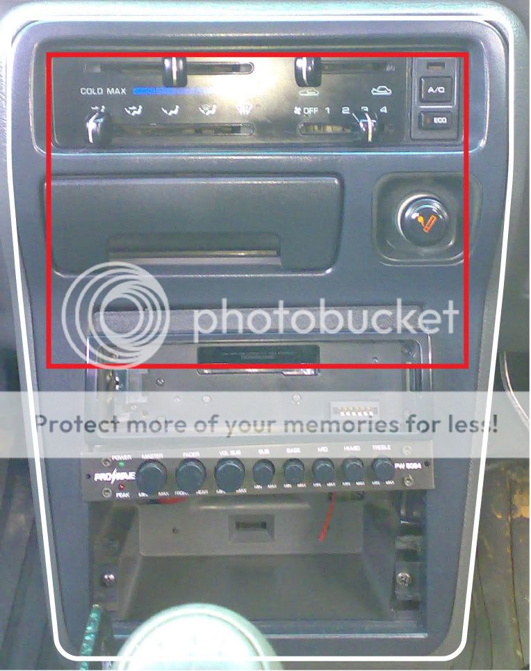

    So here is a sketch of the dimensions of the panel (it's in metric system, sorry!). The white outline marks the border of the dark-grey panel that sits inside the brighter dash framing - the photo in the background does not fit exactly since I had to correct the perspective of the picture and it did not work out exactly. Just remember the white outline has the exact size.
    Let's say the viewing area of the display is about 210 x 160 mm (got this figures from another thread here). I should have rather used the size of the whole (bare) LCD, but too late now. Add another 5-10mm at the borders of the red rectangle which marks the screen position.
    The first setup with the screen in landscape mode. It would be nice to have the screen mounted at the topmost position, but I see two problems:
    1. the screen would have to be recessed by about 2cm (at least) because of the shape of the dash that recesses at about 85mm measured from the top.
    2. It would also imply to remove the aircon controls. I've seen people on the forum do this, but I worry about the qualitiy of the result - these are all mechanical switches and I'm afraid it will be difficult to relocate them, at least for me
    The second setup mounts the screen in portrait mode, re-using the double DIN slot but extending it up to the area of the ashtray, which has to be removed.
    The screen would have to be recessed, too, but only for a smaller part at the top part of the screen. Of course the screen will be mounted very low, but will reach up due to its size.

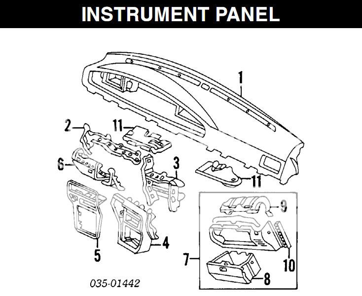

    Here is a schematics of the panel parts, seems I will have to cut out not only the covering front panel but also of the structure element behind it (No 4), e.g. the ashtray box
    So I guess the point where I lack most experience is fabrication (well, I have none), what is possible and what makes sense, what will look decent, especially related to how to tackle the problem of the recessed shape of the dash.

    Of course your first option is ideal, with the screen in landscape. Take more of your dash apart, particularlly the HVAC controls to see how they are operated. Some controls, even though they are mechanical, are actually cabled (kind of like a throttle cable or the brake cable on a bicycle). If they are cabled, it could be as easy as using longer cables to reach the noew location. If they are not cabled, then it's going to be extremely difficult to move. Also I think if you have to have the screen recressed that's actually a good thing, you will have much less glare.
