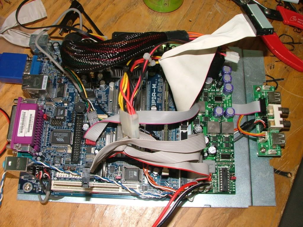

    Mother board - Via Epia m10000

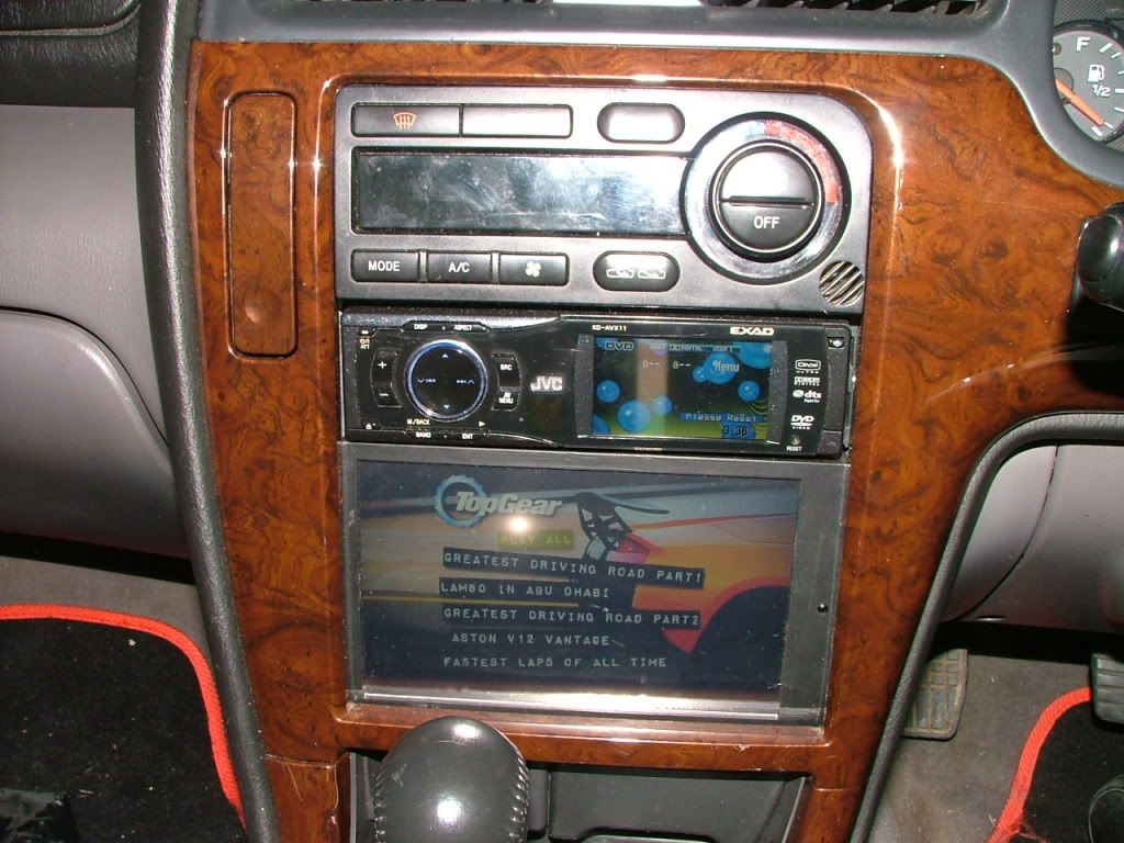

    Screen - Black Double Din LCD Frame with 7" Lilliput 629GL-70NP/C/T
    Sound/AMP DECK - JVC KD-AVX11 everything is connect to this deck it runs my sound to my speakers...

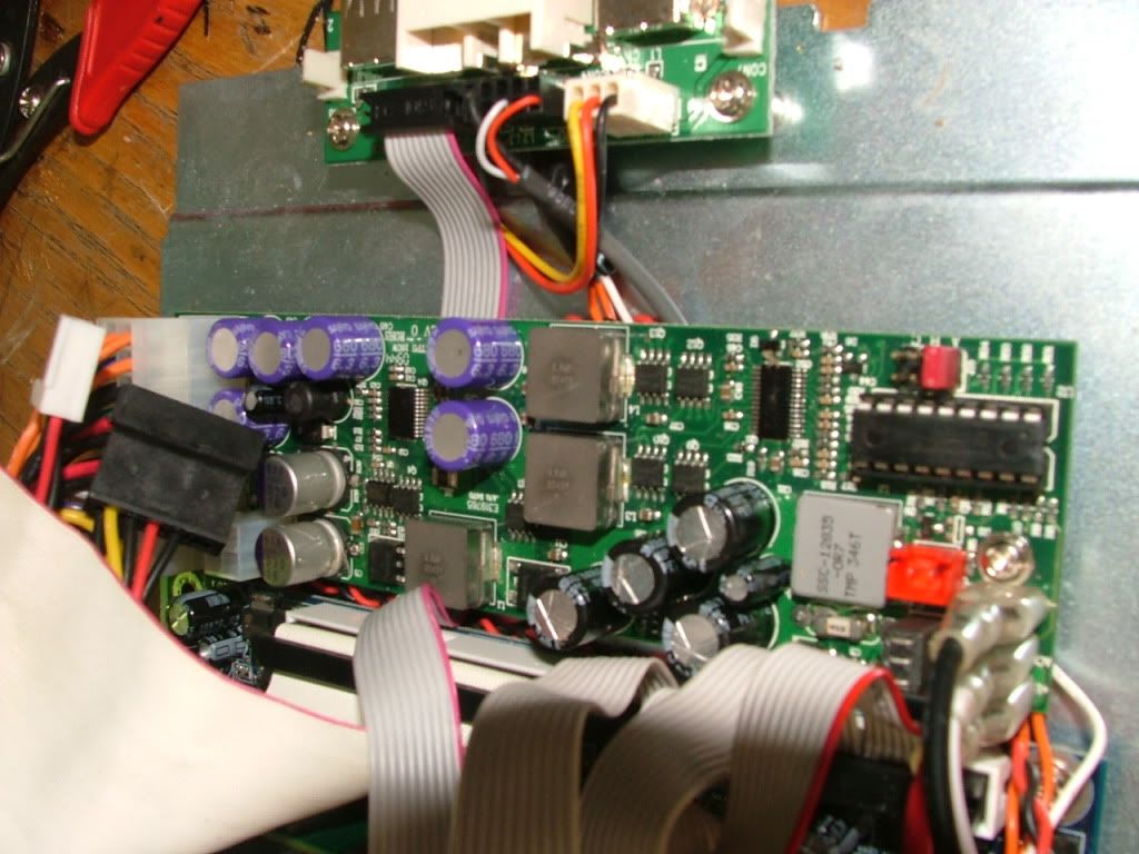

    Below power supply its my power supply and audio connection...
    My MB being assembled
    My font-end
