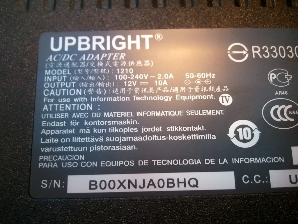

    The PSU LED lights up for 1 second when connected to my AC/DC power brick, which I am using for bench operation. I power it with a brick that use a "plug n" barrel, that is mated to the PSU's power plug. The brick I am using is pretty hefty in spec, 120W/10A/12v, and is the one recommended in numerous threads and sites for this kind of operation:

    Pics:
