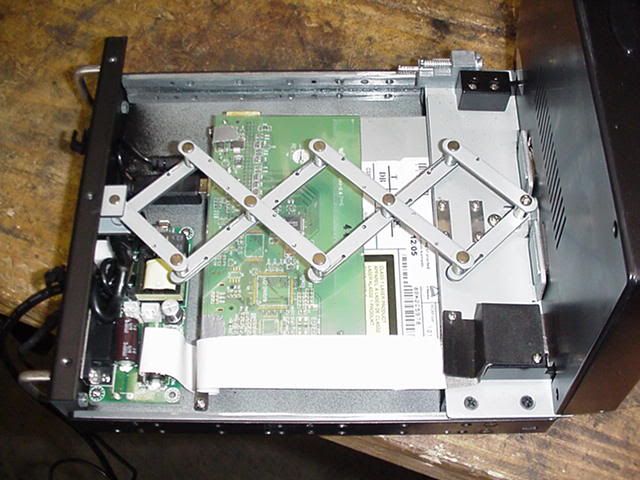

    Now I wont go into much detail about how to take the 700IDT apart. If you can build a mini computer for your car, I'm sure you can figure out how to take apart your 700IDT. Just remove the case screws, and the top case will pop off exposing the top.
    Remove the white ribbon cable carefully. A lot of people just yank out the cable. But you need to lift the tab on the connector to release the cable. As stated be carefully and donít be to rough, its very easy to break these tabs off.
    Remove the spring arm that pushes the LCD out. Then remove one of the screws that retain the roller bearings to remove the LCD completely from its case as shown.

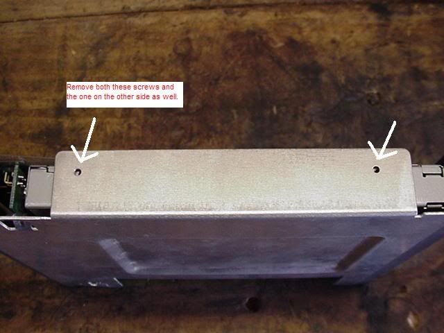

    Here is a test fit. The easiest way to get the drive thru the front since the door is bigger then the opening you just cut, you will need to remove the plastic piece on the DVD drive first. BE VERY CAREFULLY AS THE TABS ARE THIN PLASTIC, AND WILL BREAK EASILY. SO DONT FORCE ANYTHING!!!!

                Any electrical interference issues with the scissor mech. opening and closing across the pcb?
                No. There is enough room between the spring and sliding mechanism that it won't hit. And for some reason if the drive came loose and did hit it, there is a plastic shield between the pcb and the spring to prevent anything from shorting. But you should never see that happin if installed correctly.
