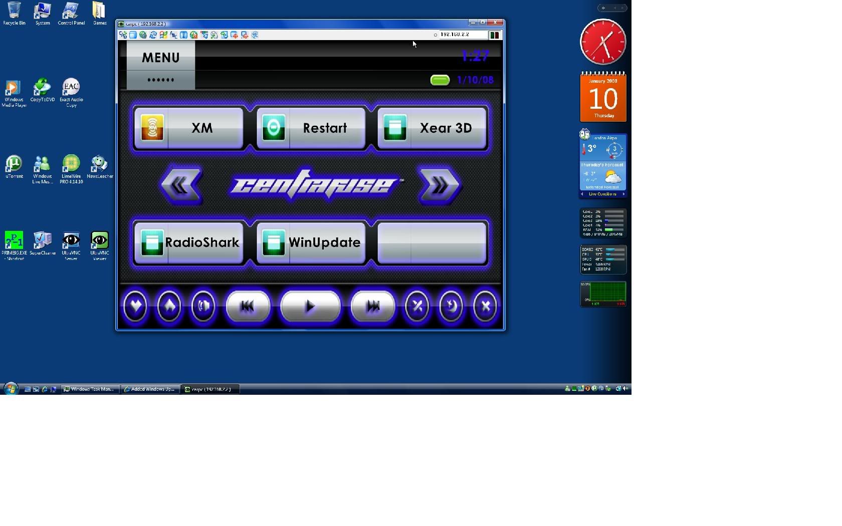

    Running a little freeware program called UltraVNC Viewer (and server)...
    The server is running as a service on the Car PC...
    The viewer program (4.6MB) is installed on a USB jump drive...
    Now, whenever I might be at a friends (with WiFi), I can use the car to connect to his network, run the UltraVNC Viewer from the USB drive in his house, and share music, make playlist, etc...basically do everything I can do while sitting in the car with keyboard + mouse!
    Here it is running off the USB drive...
    And the window with CF running in the car...
