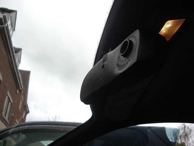

                      Just thought id update you:
                      I have remade the firewire digital camera fitted into my rear view mirror, some pics:
                      I hacked into the firewire cable to enable a switch to turn the camera on and off.
