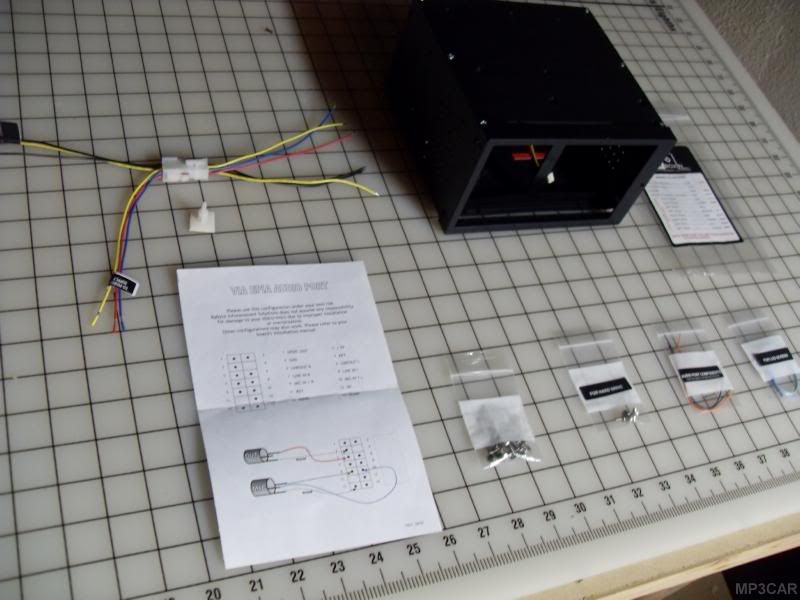

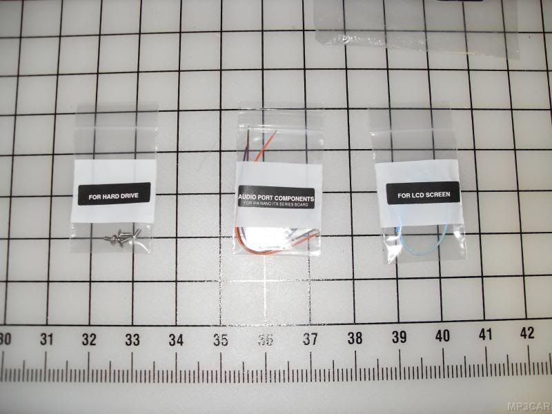

    The package arrived at my door in a quick manner from the Mp3car store via UPS, enclosed was a well packed black ABS case, and a bag containing 4 smaller bags of hardware, A main wiring harness with disconnect, and a sheet of paper with the via audio header pinout. The box also included a fair amount of packing peanuts that I chose not to photograph.
    Description:
    I began my review by spreading out the parts on my work table, placing them on a measuring grid for reference purposes. (This is a 1" x 1" grid table) The "box" itself measures out to 7"w x 7"d x 4.1"h making this a true ISO Double Din Size. The box should accept Metra, Scosche and other after market trim kits to allow direct bolt in results for most vehicles. First step was to remove the lid from the unit which is held in place by 6 screws.

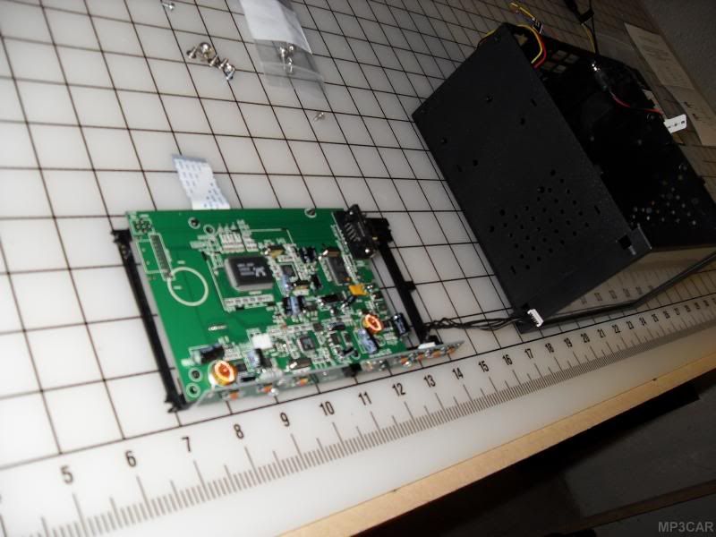

    Upon lid removal one can see an audio wiring harness, fan, 2.5" hard disk mounting provisions, and plastic standoff's arranged in a nano-ITX form factor. There are an arrary of holes in the back of the case to allow mounting of the wiring harness included in the kit, along with PS2, 5 volt out and USB surface mounting, and a nano-ITX motherboard I/O panel. The audio header looks like a direct "plug-n-play" connection to the nano ITX hardware. The wiring harness is well labeled and includes a direct power connection to the monitor hardware. For the review I used a new LED Lilliput 629 style monitor which worked perfectly with the blackbox-n. I have experience using ByByte's LCD mounting brackets so installing the Lilliput hardware was a snap. Just remove the included ABS mounting bracket from the front of the chassis and attach the LCD controller board and switch panel. This same bracket is also used to sandwich the LCD and Touchscreen panel in place. The LCD and Touchscreen fit into place snugly and accurately, installed by dropping the bottom in first and lifting them into place.
    A little tip: when mounting the switch PCB, make sure the connector sits in between the bracket and LCD controller, other wise it will be crooked and not install correctly. Circled in red here:
    Here are a few more shots of the LCD controller install, along with showing how its mounted in the case without the LCD in place for reference.
    In order to make the interface cable work in the case, the stress relief part of the cable needs to be trimmed carefully. I was able to trim it with a x-acto blade. (note this cable comes with the monitor NOT the black box kit)
