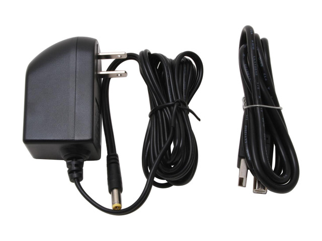

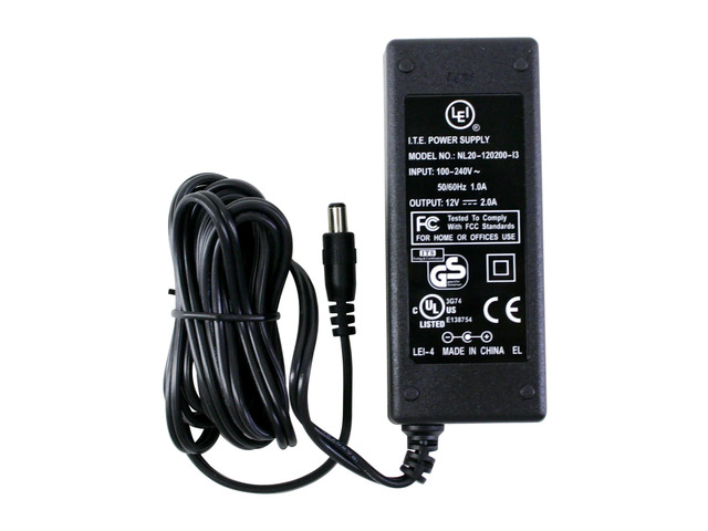

    Could I use any of the ones with AC-DC converters that output 12V like these:
    http://images10.newegg.com/NeweggIma...186-206-04.JPG
    http://images10.newegg.com/NeweggIma...155-501-03.JPG

    Okay so maybe with http://www.mp3car.com/store/product_...roducts_id=138 this might work? Can you suggest which of these enclosures should work simply by slicing the cord to 12V and ground? http://www.newegg.com/Product/Produc...SubCategory=92 Thanks!

    yes the mp3car product will definately power it because it regulates it. Any of the enclosures will work that transform the power to 12v.
