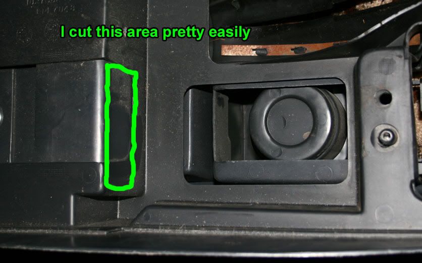

    narandomsortofw, in your pic below, do you have the little air bag or whatever box right in the way under the cupholder (on 6 speed cars)? If so, how did you route all the wires and stuff. I can't even get a finger through all that junk. Did you have to do a lot of cutting under there to make everything fit through?
    I cut a hole all the way across the bottom about 3 inches high. The electrical lines I ran down the passenger side of the console (be sure and keep the lines out of the way of the e-brake. One of wires was almost cut when I dropped it down the first time.)
    The vacuum lines i ran down the drivers side. There is enough room just make sure not to kink any lines up.

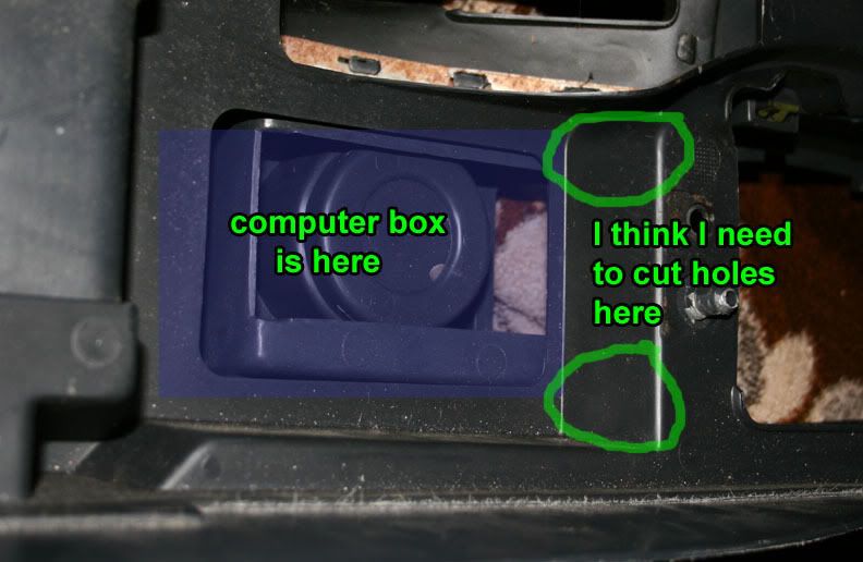

    Quote Originally Posted by narandomsortofw View Post
    I was able to cut a big hole out in that storage area, by using a long fireplace lighter to heat the plastic and then I cut it out with a razor blade in a scraper holder thing. No fumes and it sliced pretty easy.
    I happen to have an extra center console laying around so I took some pics. It seems the wires and lines are going to have to go around the computer box thing as it's right in the way. Once you are going alond both sides you run into a solid wall just ahead of it. I think I may need to cut out 2 holes for the lines to run through. The problem is, what if I need to pull the console out? I would like to run all the lines under the actual console and have them run inside only through the storage compartment hole. At that point they should be easy to disconnect from the climate control switches. It's a bit of a dilema.
    So you only had to cut the hole in the storage area by the switches?

    I only cut the main storage compartment. If you run along the sides it works. The car frame dips down where the second wall hits. I went under it. There is a group of factory wires that I followed. Just run the wires and see what works.
