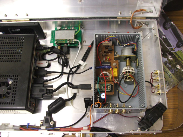

    Quote Originally Posted by Roadwarrior View Post
    Is it possible to have a photo ??
    The Module was initially mounted in a tiny metal case; this made no difference at all to noise. Locating the module close to the PC has no effect on noise performance if the DAB-module shield is grounded correctly.
    Note: The aerial lead, even if earthed within 3 inches of the socket on the DAB module, will not correctly earth the module with respect to RF interference. The braid in the Aerial lead is a shield; it’s pretty useless as an RF ground return.
