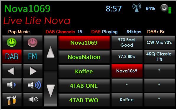

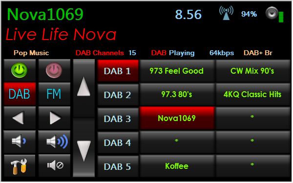

    When you rescan the DAB Stations in a new area, all DAB and FM presets are preserved. However I thought it would be a nice feature if after the scan; any Presets that were not in the new Station list could be shown with a place marker. It saves needlessly clicking on a preset only to find it does nothing. Having a place marker lets you know a preset is in that button and gives you the option of overwriting the preset or leaving it until the next DAB scan back in your home location, at which time it will reappear.
    Anyway its done and uploaded
    Preset place markers after a rescan with stations missing.
    One push DOWN of the big scroll button changes the layout from DAB 1-5 to Station list scrolling display.
    When scrolling up, DAB 1-5 reappear when you get to the top of the Station list.

    A number of FM stations are now displaying a station name instead of the frequency. The original DEMO app would not allow a Drag/Drop of a name, only a frequency, so you had to catch the freq display before setting the preset.
    My app allows you to drag / drop the Station name to a preset. The Station name is now displayed on the Preset, not the frequency. This mod means that Dexamenus who I think is the only one testing / using my app will have to redo his FM presets, apologies.
    There was also the unaddressed problem of clearing a preset. To clear a preset in my app: Click and drag the “Power on” button to a preset button and it’s cleared.
    Found a bug when pressing the Next/Previous buttons in FM, where they stayed selected: Fixed.
    Button graphics have been modified for a cleaner look so it’s best to download the complete APP if you are interested in it. (Its on Page 1)
