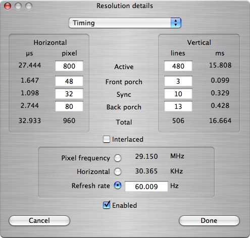

    http://www.wreckcenter.com/LCD/Lilliput/
    I didn't know the stupid "slideshow" in the webpage editor didn't necessarily work with Firefox and Internet Explorer.
    Above is a direct link to the images. You can see the settings for SwitchResX there.

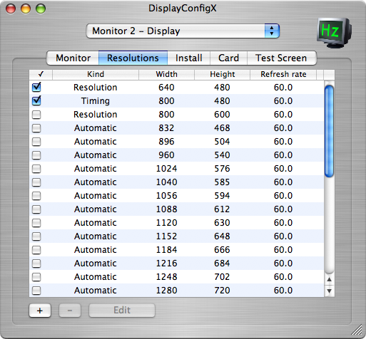

    Greetings all,
    I just bought EBY701 (they said it's new LED panel) connected to the solo MacMini and I was trying DisplayconfigX to set it up for 800x480 display. But, when I try to ad the custom resolution "Timing" is always grayed out. Does any one know why? Anyone ever seen this this problem before? I've to send it back if i can't set 800x480 on this screen. Any help/hint very much appreciated. Cheers!!!

    hey, jsut thought i would add my 2 cents... you do need to buy it to do a timing, or any other more advanced feature. i just did it and it worked fine:-)

    hi bikerdudepost, thanks for the conformation. It's about $10, I think - not rally a big deal. I tried switchResX in the mean time (full-featured demo version works for 10 days) and it worked but it's expensive. So, thinking which one to buy. Any advice/suggestion?? Cheers!!!
