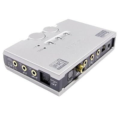

    So I've been doing some more reading and I've been looking at the Creative Labs USB Sound Blaster Audigy2 External Sound Card
    The PC I'm looking at has optical out and this external card has an optical in. Argh, just trying to find an easy way to have the fader and balancer options

    nice find, glad you haven't abandon your carpc project...
    alot of amazon's reviews said that the audio was laggy but the same reviews didn't say what connection they were using, usb (expected) or optical (superior).
    but as a side note, centrafuse has front/back left/right adjustments and you should be able to reassign the stock "line-out" 3.5mm stereo plug to "rear-output" with software. then go to any store that has car audio stuff and you can usually find a 3.5mm plug to rca adapter. confused yet?
