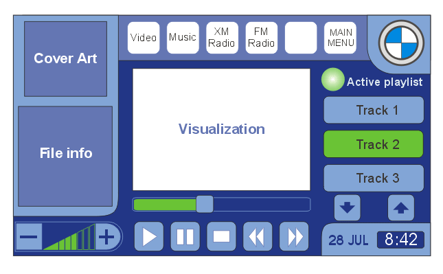

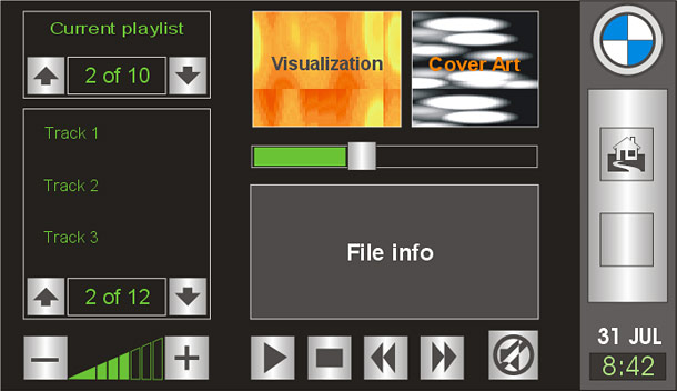

    Just wanted to share some designs I have for pycar.
    It suppose to work on touchscreen monitors. I have 2 screens ( main audio player ) with similar concept, but slightly different layout.
    Any ideas on which one is better or more functional or what's missing ?

    definitely the first is better

    First looks way cool.

    Ever think about displaying either a visual OR alblum art to save on space? Just a thought.
    BTW I like the 1st one better myself..

    Yes I thought about that. I'm still trying to get some balance between the functionality needed and simplicity though...
    Don't look at the colors yes, just functionality. I'll have some color choices mid next week.
    Thanks for feedbacks.

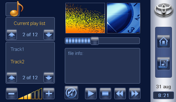

    I mostly finished all screens I wanted. So I'm working on colors and overall style. Take a look...
    Note that it is only colors and style, buttons and graphics will be added later next week.
    Let me know what you think...

    That looks great, major improvement from the first two, not that they were bad, this one is much better. Its a really good layout.
