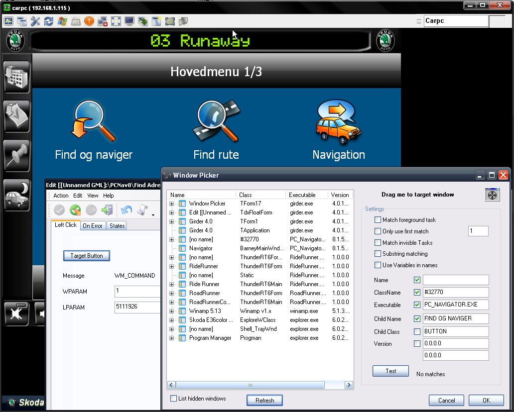

    OK, I just went back and recreated the cmd's.
    Here is the situation:
    I have RideRunner (the february release I belive) running...
    As navigation program I use PC Navigator 8.
    loading External GPS skin and PC_Nav8 starts.
    I've made a few buttons in the skin to access different buttons in the PC_Nav8 menu structure. A kind of shortcuts.
    The way they work is by activating an event in Girder 4 that in return do a series of leftclicks with W and L Parameters targeted at PC_Nav8.
    The crash of RoadRunner compatibility EXE seems to be activated with ANY "leftclick with W and L Parameter" targeted at PC_Nav8
    Just pressing test in the below image activates the crash
