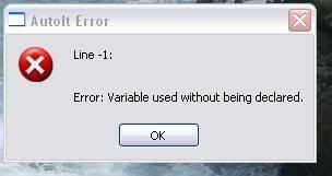

    lastly, I get this error here sometimes:
    not sure why though.
